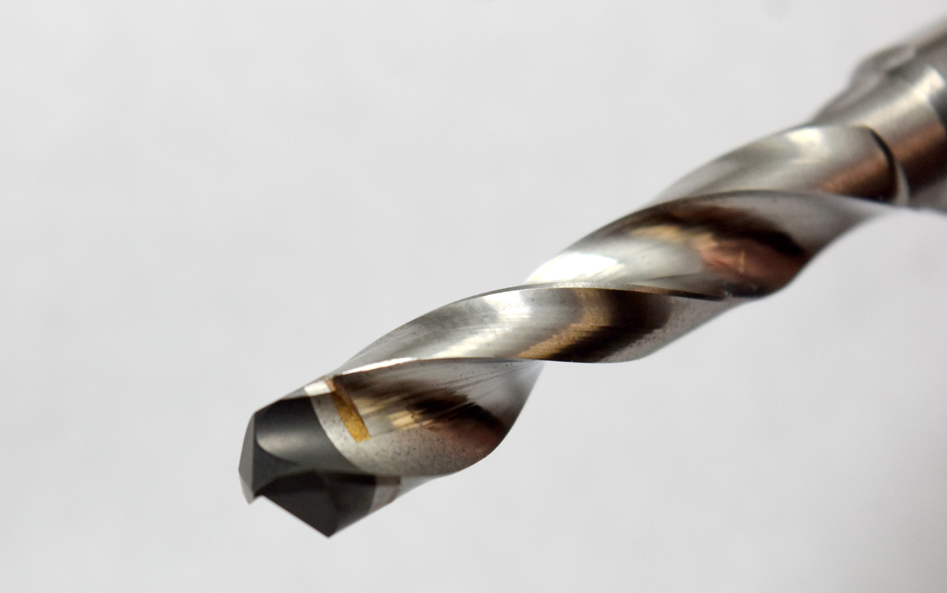

This is the tool grinding technology that first helped West Ohio Tool to develop an interim PCD tool – a specialty PCD outboard tipped drill, capable of drilling 350,000 holes in diecast aluminum without the need for regrind or re-tip of PCD.

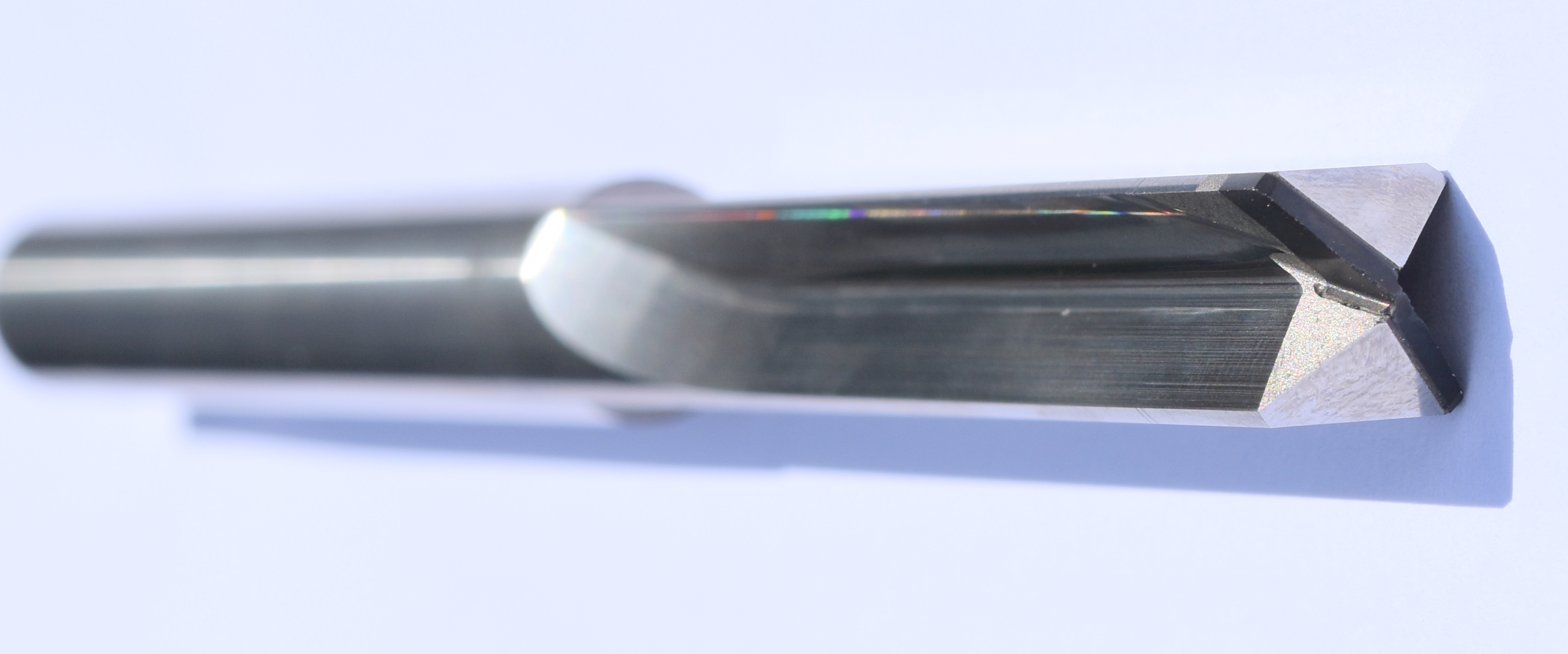

“The challenge with the outboard tip is that the outside PCD edges hold up great but the center of the chisel is still carbide, and it still eventually breaks down,” Buchenroth explained. “The goal for the new tool was to find a way to get solid PCD all the way across the center and effectively marry it to a carbide tool shank.”

The initial formulations of PCD the shop tried eventually crumbled and broke at the drill center while the outer edges were fine. This is when the shop realized that only the highest concentration of PCD would work for the new tool, so West Ohio Tool spent a total of six years of trial and error, working with different PCD materials as well as developing a proprietary brazing process to marry the PCD to carbide and tweak the tool’s geometry.

After a total of six years of continuous testing, the tool was ready. Released in 2019 and called the EdgeX4, the patent-pending PCD tool drills from 800,000 to 1,000,000 holes in diecast aluminum thanks to a significantly stronger, faster, longer and more efficient design than competing tools. Although aluminum transmission cases for the auto industry were its earliest workpieces, the EdgeX4 continues to prove a boon to the aerospace industry as well, as it is able to drill through highly abrasive carbon fiber reinforced polymer (CFRP) materials with minimal wear as it does with aluminum.
