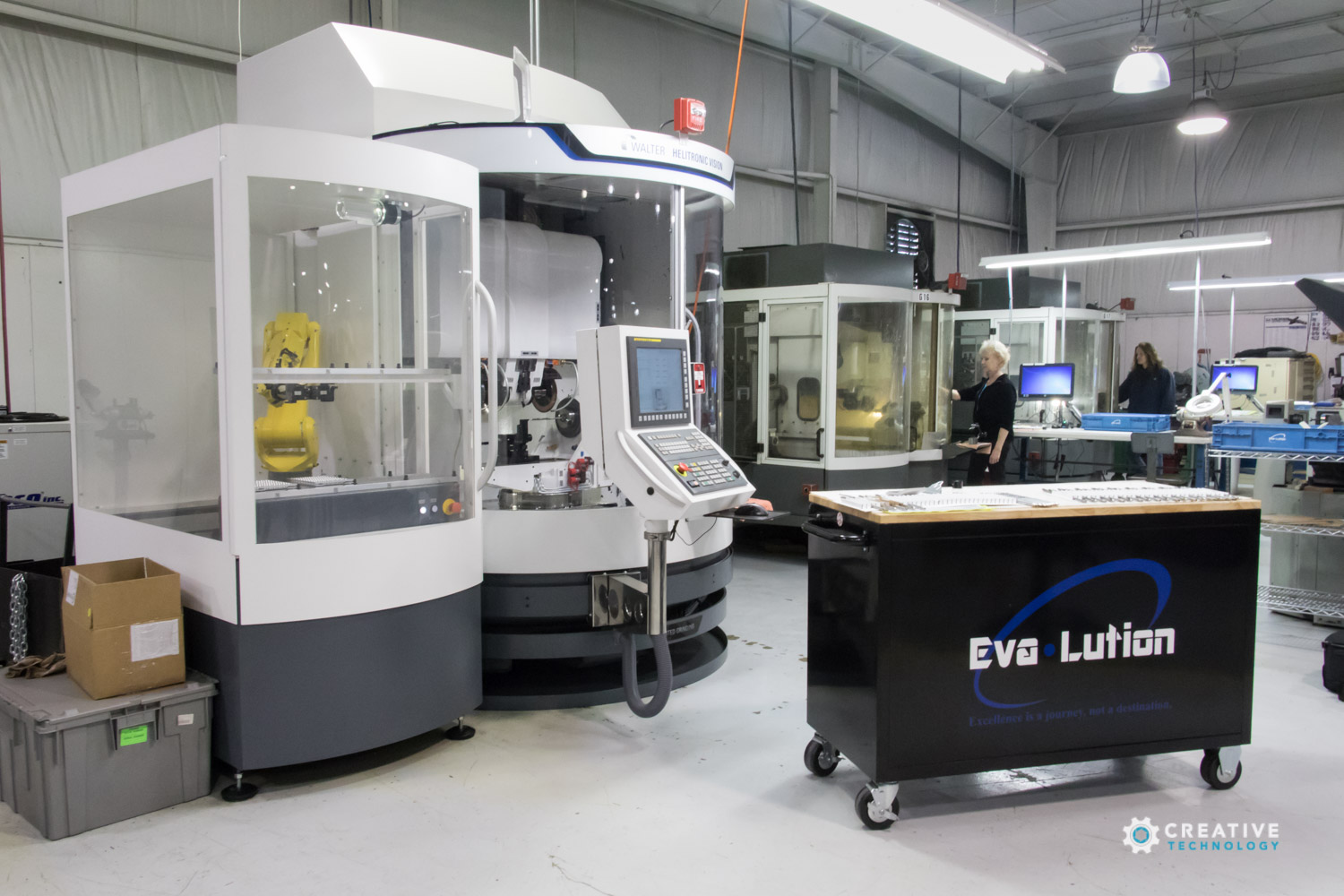

“We knew from day one that our focus had to be high-precision grinding,” said Mike Pahl, president of Eva-Lution. Initially the shop had two grinding machines equipped with flexible robot loading systems.  The two easy-to-use grinders produced precise, high quality parts in a single clamping. Eva-Lution recognized the accuracy and efficiency of these machines as the keys to its success.
The shop used its two initial grinders, MINI POWER machines from UNITED GRINDING, to increase its production of bone drills, reamers, screws and other surgical implements for the medical industry. With the influx of medical work, Eva-Lution was able to add a 5-axis WALTER HELITRONIC ESSENTIAL CNC tool grinder, two WALTER HELITRONIC VISION tool grinders and most recently a WALTER HELICHECK measuring system – all also from UNITED GRINDING. The newer grinders were also equipped with automation for lights-out operation to further expand the shop’s overall capacity.
