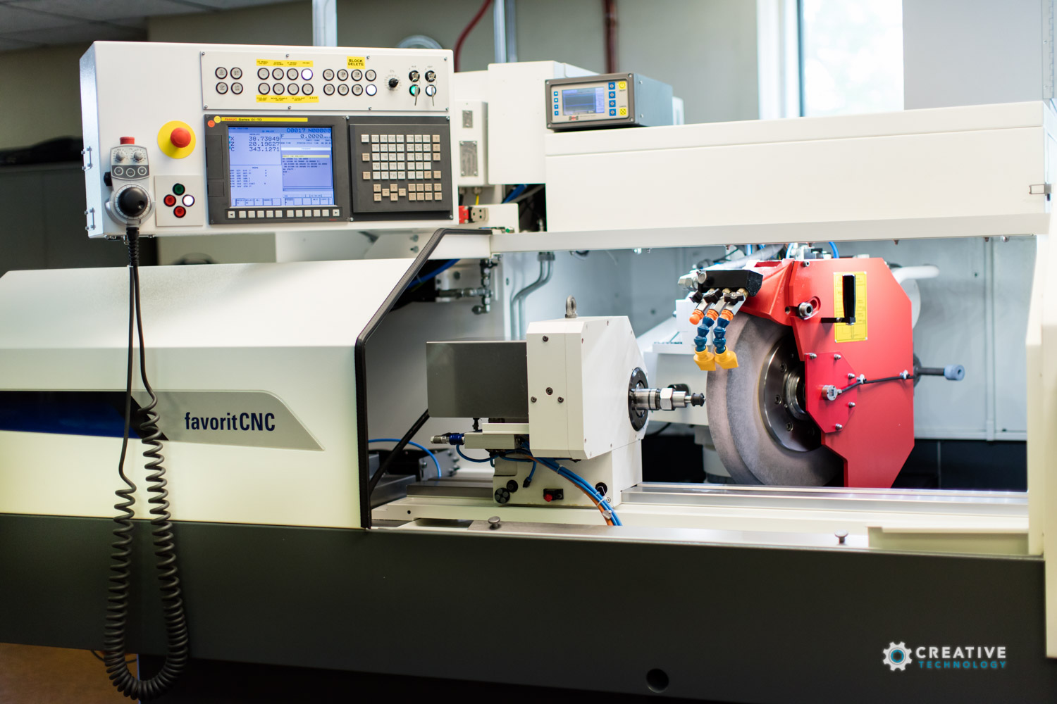

The STUDER favoritCNC from UNITED GRINDING is designed for the production of individual or small-run medium-sized parts. This is important to J.H. Benedict because it needs grinding technologies that work well for orders that may only consist of a couple pieces. The favoritCNC is also easily retrofitted to perform other grinding tasks.

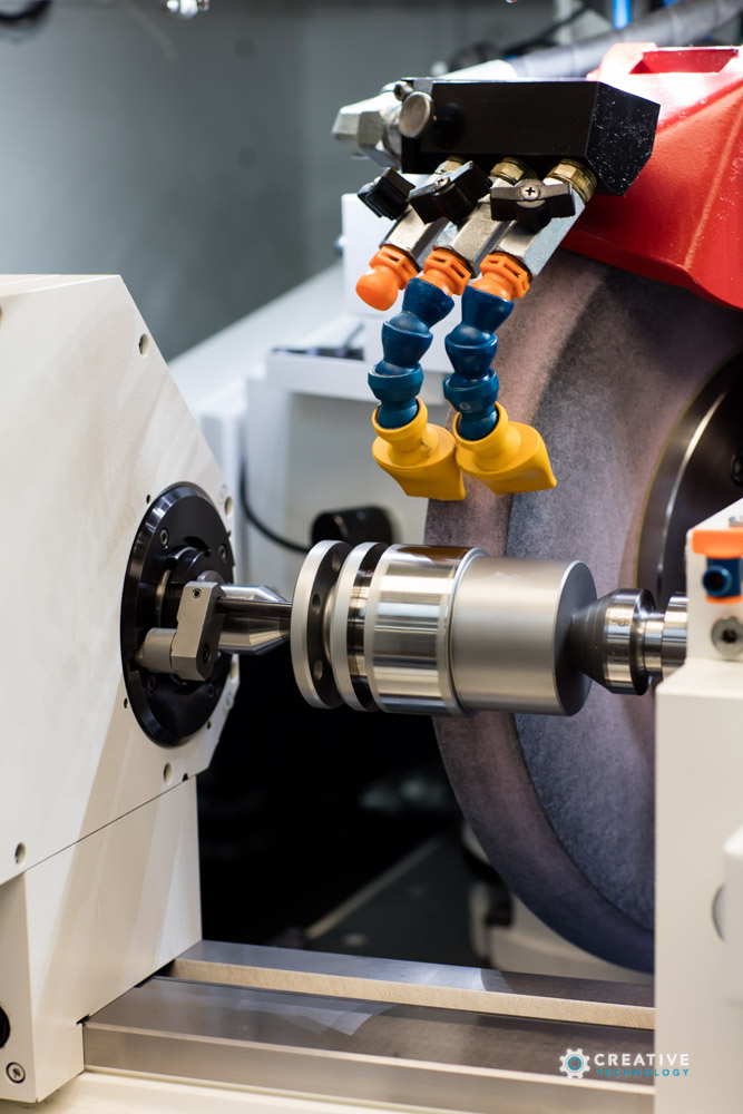

As a job shop, J.H. Benedict works with a broad range of part sizes and materials on its STUDER favoritCNC. The shop’s smallest parts measure under an eighth of an inch in diameter, while its largest parts are up to 13.5 inches in diameter. J.H. Benedict uses materials that include aluminum, stainless steel, 86-20 steel and rubber. The rubber is ground with an aggressive aluminum oxide wheel, while most other materials are ground with ceramic wheels.
J.H. Benedict’s STUDER grinding equipment has dramatically reduced the shop’s setup times. Its favoritCNC is equipped with an auto-balancer that makes wheel changes fast and easy. An additional boost to setup speeds comes from the shop’s stock of several different versatile wheels that perform well in multiple applications.
An additional time saver for J.H. Benedict is STUDER’s StuderGRIND software. The software is equipped with pre-set, standard grinding programs that can be tailored to an application. The shop reduces the time necessary to setup a part because an operator can edit a pre-set program instead of creating it entirely from scratch. Also, J.H. Benedict can save programs and reuse them when it runs jobs in multiple small batches over time.
Another valuable feature of the STUDER favoritCNC is its reliability and consistency. The CNC guarantees that exactly the right amount of material is ground away every time. It significantly reduces error over what an operator could accomplish with manual grinding, which leads to reduced waste.
