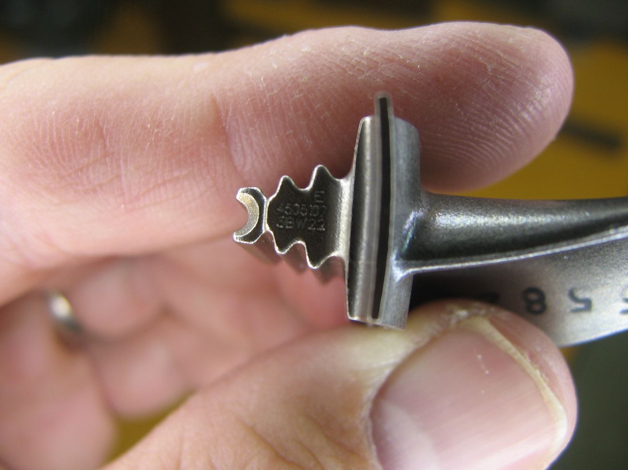

Form Grind produces turbine blades with tight tolerances and rigid specifications, ranging in size from a few inches to over two feet long. For example, some blades must meet weight tolerances reaching three decimals in grams in addition to strict dimensional requirements. Because turbine engine manufacturers continually raise the operating temperatures of their products to reduce emissions and increase efficiency, the blades often feature complex contours and internal coring engineered to manage heat. The acute contours and coring increase the challenges of grinding and fixturing the blades.

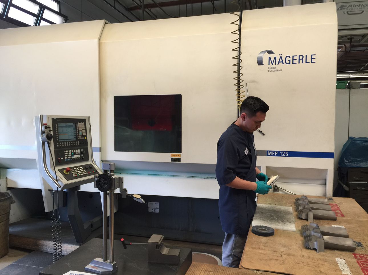

Blade dimensions are verified through dual inspection methods. Treichler said Form Grind always submits the parts it grinds to two methods of inspection: “We check first articles in the inspection room where we have a
CMM and a 30" optical comparator, then we empower the operators to perform in-process inspection.” At each of the more than 25 different grinders on the shop floor, there is a surface plate where the operator can use hard tooling and different types of go/no go and plug gages that verify certain part features.
For final inspection, the CMM holds parts in a free state to check and verify the six point nest dimensional features on the blade. Such overall verification is not possible in process when a part moves from machine to machine for different operations.
“Turbine blades tend to have 100 percent in-process inspection, and in final inspection we do a statistical process sampling,” Treichler said.
Treichler is a firm believer in the key role of grinding in the production of precision parts, especially of gas turbine components. “A company tries to mill a feature then sends the part out to heat treat and gets distortion. Then they try to fix those distortions,” he said. “Milling can be consistent and accurate, but for features such as fir trees with 0.002" tolerances, the speed and capability of the diamond dresser to dress all those points on a conventional wheel and grind them all at once offers a clear advantage. The beauty with creep feed grinding or profile grinding is that you can grind hardened materials directly to size.”
