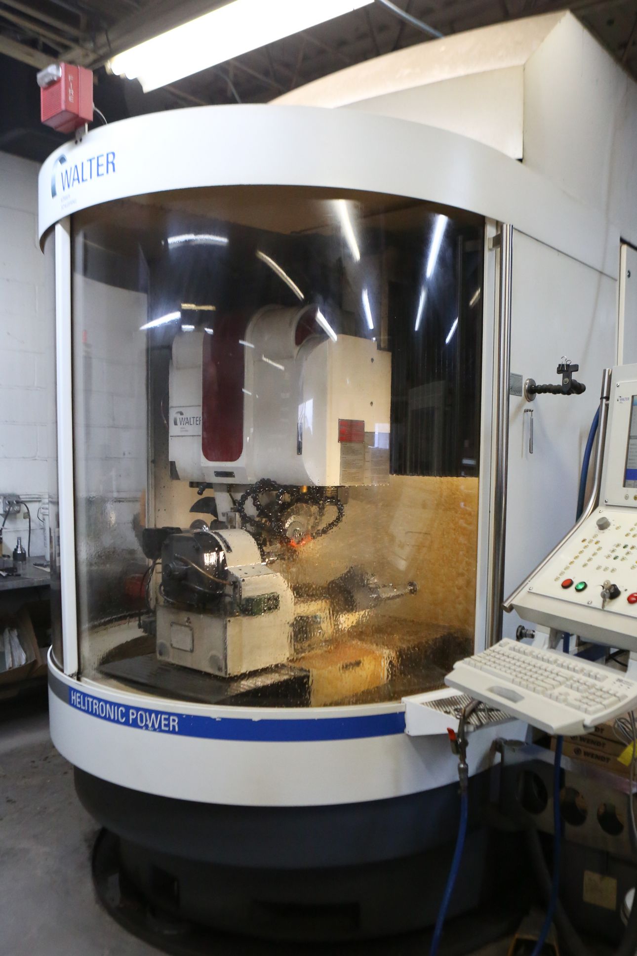

Most of the company’s stock dies are still produced by hobbing and lapping. The WALTER grinders provide flexible production of special patterns, short-run jobs and orders that require a very quick turnaround—in some cases, the same day. Form Roll Die uses two WALTER HELITRONIC POWER 400s and a WALTER HELITRONIC 45. The HELITRONIC 45 machine continuously runs 90-degree basic form work, while one of the HELITRONIC POWER 400s is typically set up for 79-degree work on diametral dies. But, at any given time, the shop can easily shift production based on machine availability.
Form Roll Die’s newer WALTER HELITRONIC POWER 600 is used strictly for custom work. According to CAD/CAM Engineer Barry Wilson, the machine allows the company to take on specialized projects that would have been impossible or cost-prohibitive using the shop’s hobbing and lapping production method. When making tools with this technique, Form Roll Die first hobs the knurling pattern onto a die, then sends the workpiece through heat treat. From there, the die is lapped to a smoother finish then surface and ID ground before finally going to inspection.
With the HELITRONIC POWER 600, the shop is pretty much just working from hardened blanks—a change that can cut lead times by up to 50 percent.

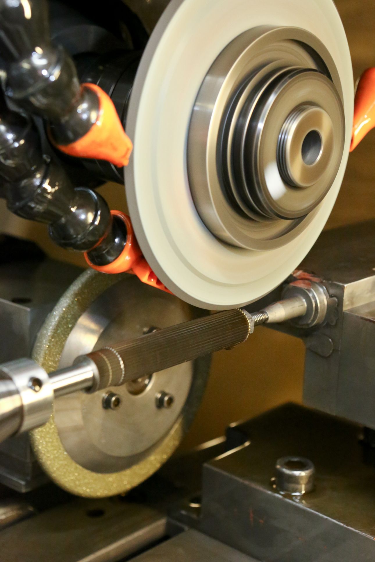

The machine allows Form Roll Die to produce knurling dies with accuracy and complexity that would be challenging to achieve using the hob/lap method. Many of the jobs Wilson performs on the machine have tolerance requirements of 0.0005". He has also used it to produce dies with widths as small as as 0.030". Plus, if a customer wants to refine a special die, Wilson can quickly make the change on the CNC machine and have the job running in as little as 45 minutes.
Recently, Wilson developed a specialty tap for a medical-based customer that was 0.056" in diameter, had 60 teeth per inch and featured a thread root of around 0.0015" for producing lead nuts. He also made the matching lead screw die. Together, these critical tools help make robotic jaws that are used by operating physicians during thoracic surgeries.

Currently, Form Roll Die operates its HELITRONIC POWER 600 for a single shift, five days a week. The machine’s electrical rotary dresser allows the company to dress the wheels during the grinding cycle when necessary. “It’s all about teeth per inch and diameter length, and every application is different,” Wilson said. When it finally comes time to dress a wheel, which can be days or months, he has the machine do it in 0.0001" increments. In general, he uses rotary diamond wheels on special knurling forms and recoatable diamond dressing rolls on standard designs.
