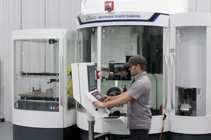

Among the shop’s newest machines is the WALTER HELITRONIC POWER DIAMOND two-in-one system that performs grinding and electrical discharge machining (EDM). With copper rotary erosion/electrode wheels, the machine EDMs the PCD portions of tools, then conventionally grinds the carbide areas. West Ohio Tool was the first shop in North America to acquire this most recent version of the HELITRONIC POWER DIAMOND, and according to Buchenroth, the machine represents a huge leap in tool production.
Diamond/PCD is tough to grind, and the only wheels available to grind it are those made from diamond. Unfortunately, the scenario creates a one-to-one grinding ratio, meaning the grinding wheel wears equally to the amounts of part material it is removing, which makes the process costly.
Because manmade diamond (PCD) has cobalt present within the diamond layer, the material is conductive and therefore well suited for the EDM process. This type of machine capability, along with combined advances in brazing and PCD materials, West Ohio Tool is able to create new products and solutions not possible in the past.
The fully automated HELITRONIC POWER DIAMOND provides complete machining in single clamping cycles. It changes from grinding to eroding, or vice versa, on-the-fly and automatically. In addition to PCD and carbide, the machine processes tools from high-speed steel, cermet and ceramics in diameters from 3 to 320 mm, lengths up to 350 mm and weights as heavy as 50 kg.
The machine’s robot improves accessibility to workpieces and makes special applications possible. Depending on the workpiece type or diameter, up to 3,500 parts can be loaded using the robot.
