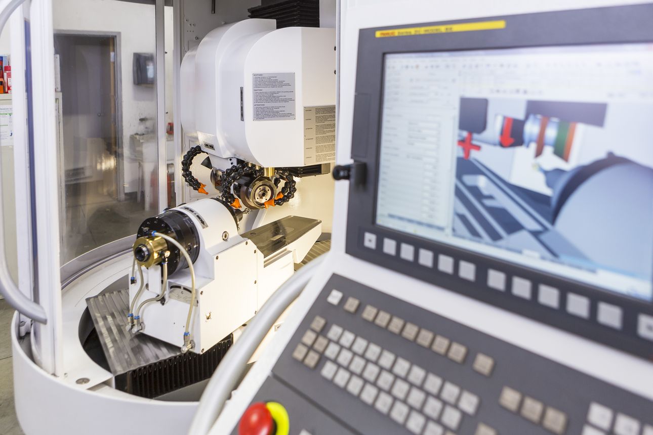

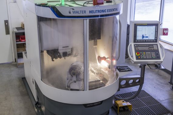

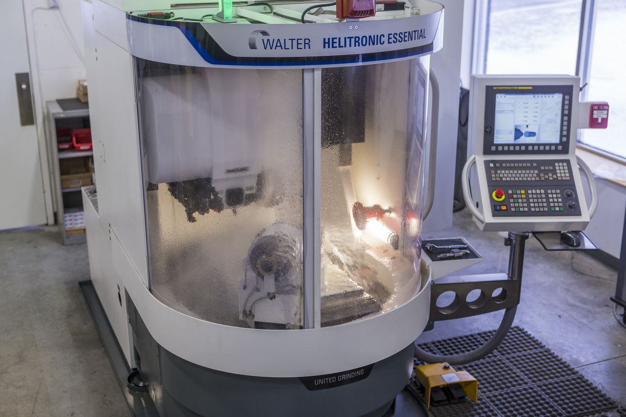

Working with John Manley from United Grinding distributor Machine Tool Systems in Toronto, Laflamme purchased a Walter HELITRONIC Essential CNC tool grinder. The 5-axis machine is engineered for flexible, economic regrinding and production of rotationally symmetrical tools from 1 – 100 mm in diameter and up to 255 mm in length.
Walter supplies HELITRONIC Tool Studio software with the machine. Laflamme added that the software’s optional step tool wizard and an advanced license that enables a tool design to be individually modified or adapted facilitate creation of user-defined tools.

“If I want to stay in business, I have to grind carbide,” added Laflamme. “Most manufacturers believe that a CNC machine will provide more precise and consistent results than manual equipment when grinding carbide. And basically that’s true. A CNC grinder produces perfect, repeatable tool geometries, where manual grinding is very good but not always perfect.”
According to Laflamme, the relatively slower cutting speeds involved when regrinding carbide tools on manual grinders can generate excessive heat. The heat creates micro cracks in the carbide unseen by the naked eye but that can accelerate tool wear.
