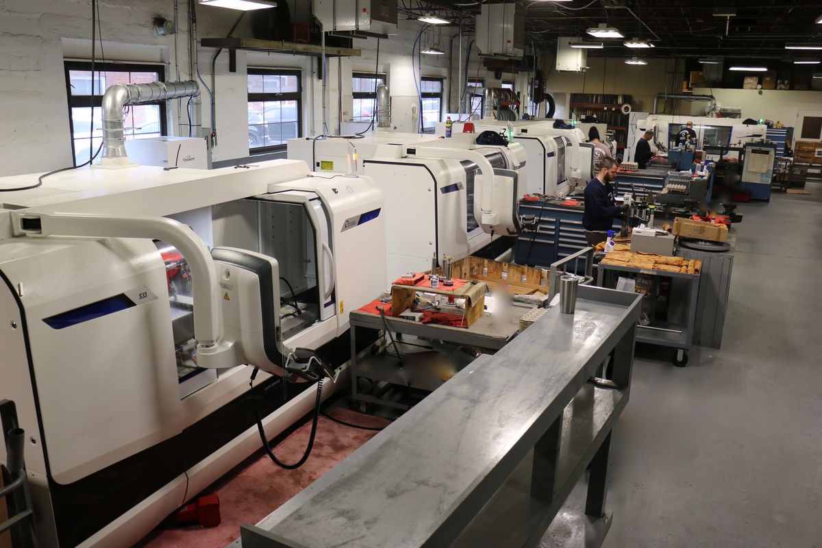

For its cylindrical grinding needs, Globe Grinding has been a loyal STUDER customer over the last two decades. The shop routinely upgrades its equipment to stay on the cutting edge of manufacturing technology; after acquiring a second S30 Lean Pro, for example, the shop sold those first machines – which retained much of their value – and acquired a STUDER S33. Most recently, Globe Grinding has added more of the latest STUDER S33 models with the hydraulic tailstock required for later integration with the company’s automation solution, the UNITED GRINDING flexLoad.

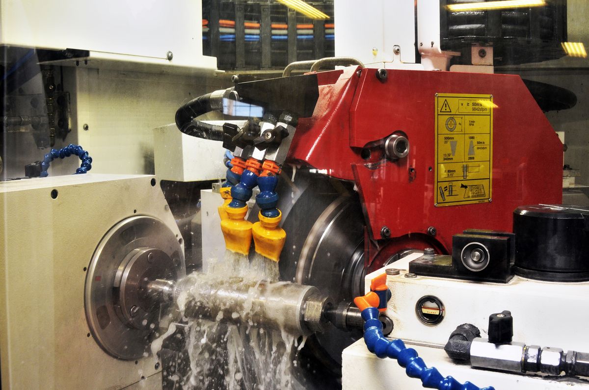

As a universal cylindrical grinder, the STUDER S33’s dual spindles permit both external and internal grinding in one setup. For additional flexibility, the machines can be quickly converted from live spindle grinding to grinding between centers, all of which serves to help Globe Grinding meet the ambitious production schedules set by its customers.
The STUDER S33s tout a 0.000016" (0.0004 mm) standard roundness accuracy during live grinding and easily handle individual and batch production of medium-size workpieces. Globe Grinding purchased models with a distance between centers of 39.4" (1,000 mm) and center height of 6.9" (175 mm). With C axes, the machines can form and thread grind as well for the greatest level of process versatility.
