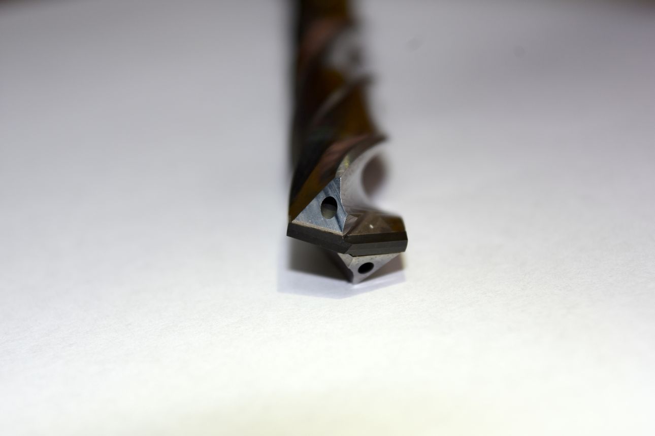

This is the tool grinding technology that first helped West Ohio Tool to develop an interim PCD tool – a specialty PCD outboard tipped drill, capable of drilling 350,000 holes in diecast aluminum without the need for regrind or re-tip of PCD.
Customers have whole-heartedly embraced these outboard-tipped drills – including the automotive OEM customer whose PCD tool business they’d lost earlier. However, that same OEM was fighting the industry-wide battle for faster throughput and lower total cost of production and insisted on more. According to Buchenroth, the customer said that drilling 350,000 holes without interruption was good but asked if we could make it even better in terms of output, so the West Ohio Tool team got to work.

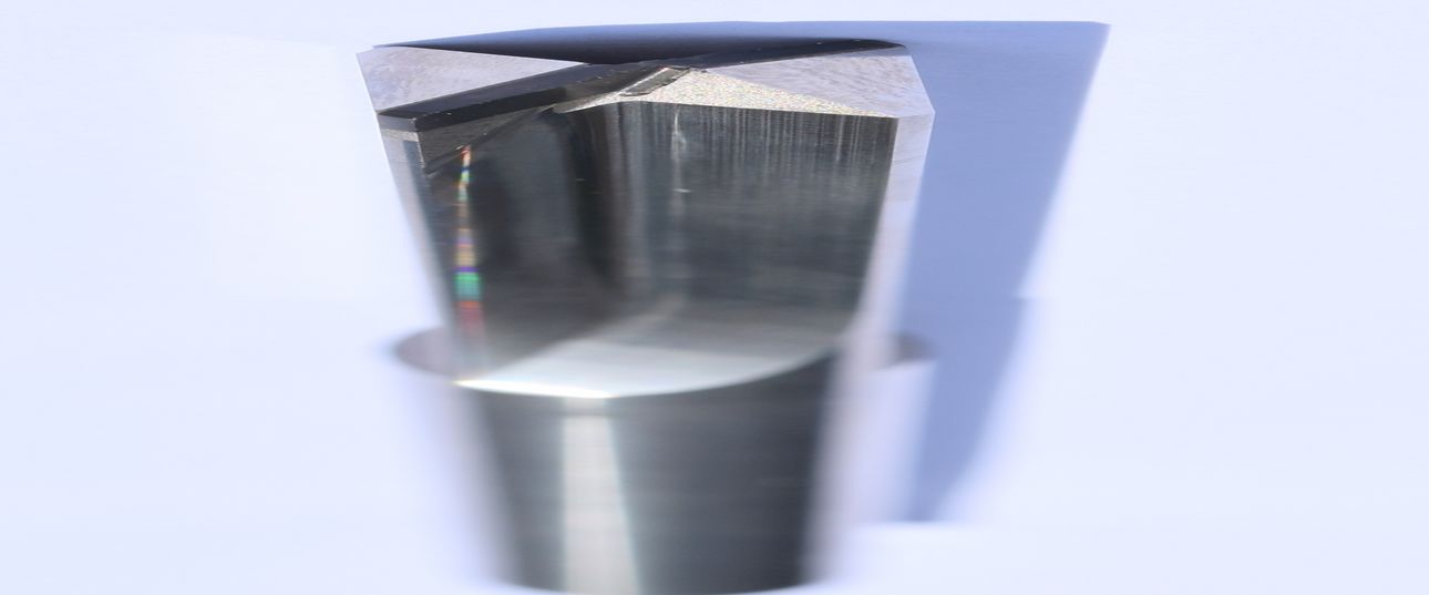

“The challenge with the outboard tip is that the outside PCD edges hold up great but the center of the chisel is still carbide, and it still eventually breaks down,” Buchenroth explained. “The goal for the new tool was to find a way to get solid PCD all the way across the center and effectively marry it to a carbide tool shank.”
Buchenroth knew that to develop and produce such a cost-effective, durable solid PCD tool, they would need an even more efficient solution for working with PCD materials.
Diamond-hard PCD is tough to grind, and the diamond grinding wheels used to do so wear out quickly – every amount of PCD material removed from the workpiece equates to the same amount of PCD that’s worn away from the grinding wheel. This makes grinding PCD an expensive endeavor. However, because PCD contains cobalt, it conducts electricity and therefore is well-suited for electrical discharge machining (EDM).
With the solid PCD tool project in mind, West Ohio Tool invested in the WALTER HELITRONIC POWER DIAMOND with both grinding and EDM capabilities. With copper rotary erosion/electrode wheels, the machine EDMs the PCD portions of tools, then conventionally grinds any carbide areas.
The fully automated HELITRONIC POWER DIAMOND provides complete machining in single clamping cycles. It changes from grinding to eroding, or vice versa, on-the-fly and automatically. In addition to PCD and carbide, the machine processes tools from high-speed steel, cermet and ceramics in diameters from 3 to 320 mm, lengths up to 350 mm and weights as heavy as 50 kg.
This was also about the time that the shop invested in its fully automated HELICHECK PRO measuring machine that can handle tools with a diameter range from 1 to 150 mm in the macro area, a machining length up to 330 mm and a tool weight of up to 25 kg. The CNC-based system is well-suited for fully automatic measurement of complex tool geometries such as with the new PCD drill.
Crucial to the drill development process was working with different formulations of the PCD material. PCD is measured by grain sizes that range from nanometers to hundreds of micrometers, usually referred to as nanocrystalline and microcrystalline. Smaller particles in higher concentration provide higher grade tooling, according to Buchenroth.
Using inferior PCD leads to a breakdown similar to what eventually happens with outboard tips on carbide – outer cutting edges would be fine, but the center eventually fails or the PCD is too brittle to hold up to aggressive machining. Buchenroth likened the phenomenon to the children’s game of crack the whip.
“In the old game of ‘crack the whip,’ the child at the center basically rotates around very, very slowly in one spot while the person at the tip of the human whip is sent flying around. PCD is great at the ‘flying around’ part, as it cuts away at material at the edge of the tool,” said Buchenroth, “but at the center of the drill, where there’s zero surface footage, it doesn’t react well to being under that kind of pressure.”
The initial formulations of PCD the shop tried eventually crumbled and broke at the drill center while the outer edges were fine. This is when the shop realized that only the highest concentration of PCD would work for the new tool, so West Ohio Tool spent a total of six years of trial and error, working with different PCD materials as well as developing a proprietary brazing process to marry the PCD to carbide and tweak the tool’s geometry.

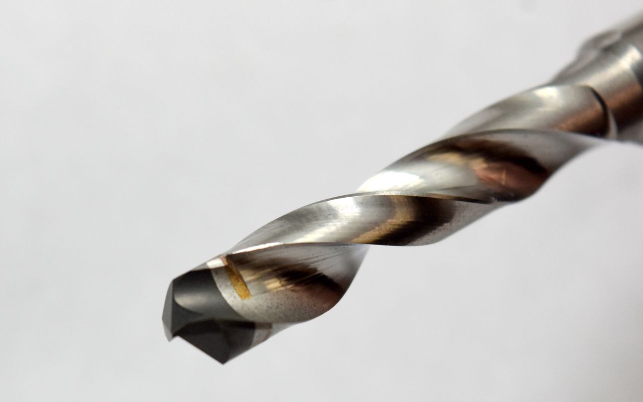

After a total of six years of continuous testing, the tool was ready. Released in 2019 and called the EdgeX4, the patent-pending PCD tool drills from 800,000 to 1,000,000 holes in diecast aluminum thanks to a significantly stronger, faster, longer and more efficient design than competing tools. Although aluminum transmission cases for the auto industry were its earliest workpieces, the EdgeX4 continues to prove a boon to the aerospace industry as well, as it is able to drill through highly abrasive carbon fiber reinforced polymer (CFRP) materials with minimal wear as it does with aluminum.
The EdgeX4 has another advantage, Buchenroth noted. Along with being extraordinarily slow to wear, the tool is relatively quickly made to order. The company’s expertise and advanced WALTER cutter grinding machine technology enables West Ohio Tool to provide the new drill within a four to six-week delivery time – about four times faster than average for other specialty PCD tools – to truly help its customers get the “edge” on the competition.
