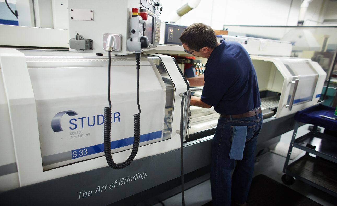

Accordingly, to boost flexibility as well as part changeover and processing speeds, Long’s Machine, in 2006, acquired its first CNC grinder, a STUDER S33 Universal Cylindrical grinder through United Grinding North America. The shop experienced such remarkable success with the machine, that it purchased another in 2015. The two STUDERS now enable the shop to carry out its new initiatives of doing less hard turning and more precision grinding for effective JIT production.
Mike Long, vice president at Long’s Machine and Leonard Long’s son, said that the shop programs and runs all its shafts on the STUDER machines regardless of shaft size or shape. But he strongly emphasized that the grinders’ main benefits are their accuracy, speed and easy changeovers.

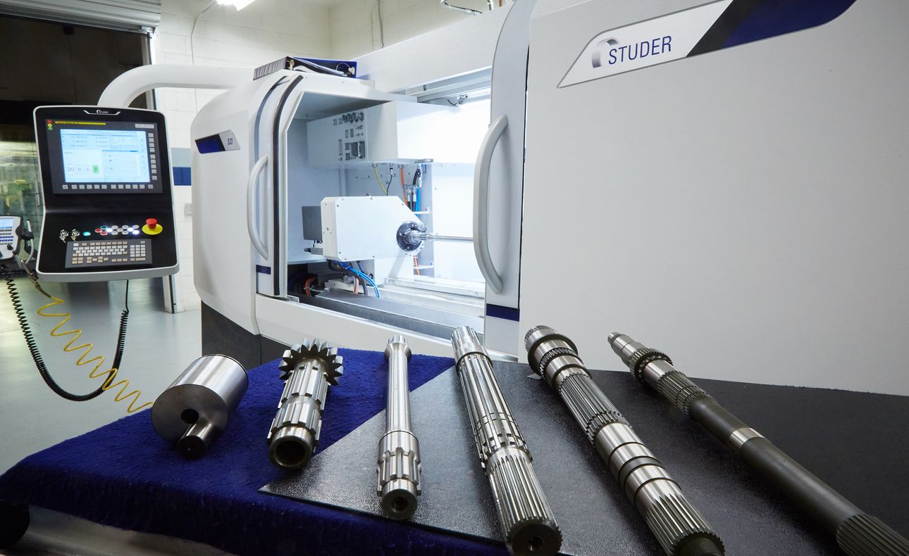

Long’s Machine O.D. grinds transmission input shafts, main shafts and lower shafts with the STUDER machines, which can handle part lengths up to 25". The two machines have similar capabilities, although the newer one includes the StuderTechnologyIntegrated feature that automatically generates ISO grinding codes.
“In our manufacturing environment, we have to be able to change over quickly,” said Long. “There’s very little time to waste. We have to be able to load a part, touch it off and go. And once parts come off the grinder, they go right into a transmission. The machines give us a competitive advantage in terms of product quality and short delivery times. Our customers might wait about two weeks for parts from us, but two or three months from another shop, and that is quite a dramatic time difference.”

In contract machining projects, workpiece materials range from steels and aluminums to nickel base alloy and titanium aerospace materials. Steel alloys are the primary workpiece materials for transmission components, with the majority of shafts made from 8620 or 4340 steel. The 4340 shafts normally are pre-heat treated, while the 8620 parts are case hardened. Typical mainshafts are 20"to 21" long and between 2" and 3" in diameter, with five to six different journals per shaft to be ground. The shafts are typically case hardened to 60 HRC, and volumes vary. But production of input shafts with three journals that require grinding, for example, averages about 40 or 50 a day with a maximum output of 80.
