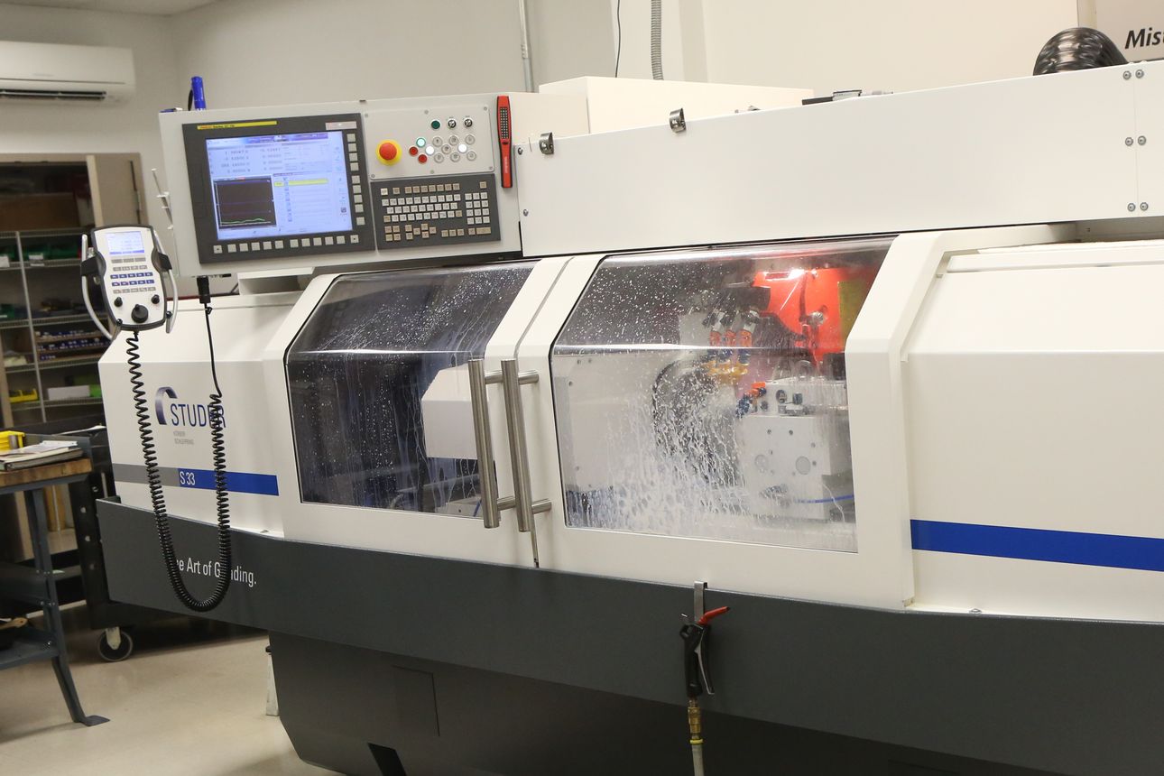

After thoroughly researching available grinding technology, J&E purchased a Studer S33 CNC universal cylindrical grinder from United Grinding in mid-2013. The S33 processes medium-sized workpieces in individual and batch production and features one ID wheel and two OD wheels. Its wheelhead has two motor spindles for external grinding as well as an internal grinding attachment, which allows J&E to grind complex workpieces in single clampings.
United Grinding helped J&E get up to speed quickly with the new machine. “They came into our facility and trained us for a week up front,” Labrie said. “Then, after we ran the machine for a while, they came back for another week once we knew more about what we were doing and had more questions.”
With the acquisition of the Studer grinder, J&E regained full control of its grinding process. “If I want to put two shifts on a part, I can, if I want to run over the weekend, the machine will. That is huge when it comes to delivery,” Labrie said. “And, we no longer subcontract out our grinding work.”

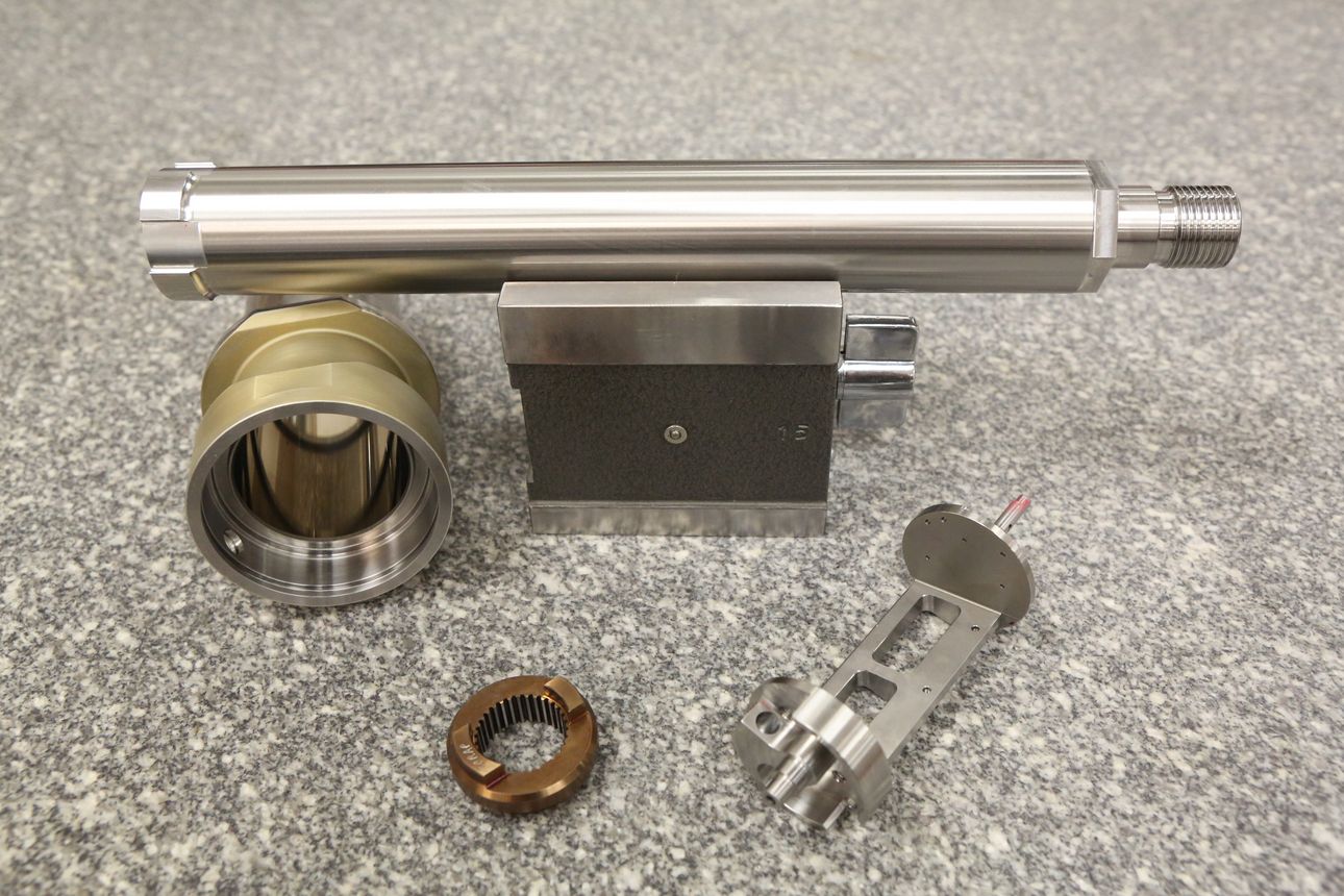

From its work on aerospace and defense projects, J&E is familiar with machining of high-performance materials such as stainless steels, titaniums, nickel base alloys and aluminum. But what takes the shop to the next level, according to Labrie, is grinding those materials.
When grinding exotic materials, he explained, choices of wheel types, speeds and feeds and cutting fluids can make a significant difference in final part dimensions and quality. The shop occasionally resorts to trial and error to find optimal grinding parameters, but the grinding knowledge and experience of staff personnel usually produce the best combinations of tooling and parameters. The machine’s operators also program the shop’s grinding processes.
Creating effective grinding setups is another challenge. Labrie said that setups occasionally involve “crazy stuff and other unique fixtures” to hold parts because not all of them are round and simple to clamp.
“With tight tolerances you don’t want to squeeze a thin-walled part out of round, or push the process too hard, or add stresses during grinding,” he advised. “And fixturing is often the determining factor of whether or not a part is acceptable once grinding is complete.”
