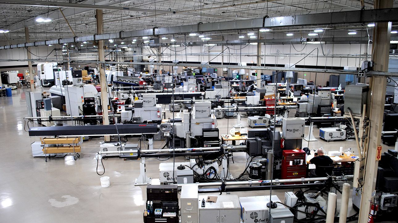

Hammill has been using STUDER cylindrical grinders for 35 years, and at one time was one of the largest STUDER customers in the country with eight grinders. Co-Op Tool utilizes two Studer S33 Lean Pro CNC grinders and a Studer S30 automatic grinder to produce the tight-tolerance components required in their work holding devices. The medical division has been utilizing a Studer S33 LeanPro to support its ongoing tooling, gaging and fixturing requirements.

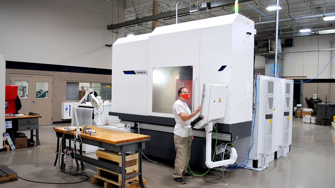

The medical division recently invested in a heavy duty BLOHM PROFIMAT MT surface and profile grinder. That purchase has allowed Hammill to take an innovative approach with a tricky part and will provide new opportunities for them in the medical manufacturing sector.

Hammill Medical bought the BLOHM PROFIMAT MT to employ the CDCF process, which involves continuously dressing the wheel while grinding the part. The surface and profile grinder worked as expected. Hammill no longer had to stop production for dressing, instead dressing and grinding simultaneously while being more aggressive with cuts.
As a result, Hammill has been able to maintain the profile shape and the size of the part and reduce the cycle time to about 10 minutes. They have significantly reduced downtime and scrap while producing a higher-quality part.
