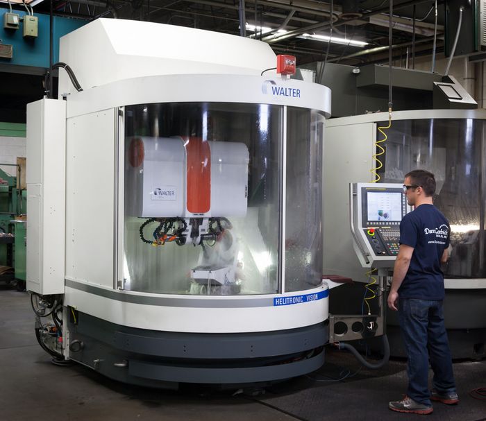

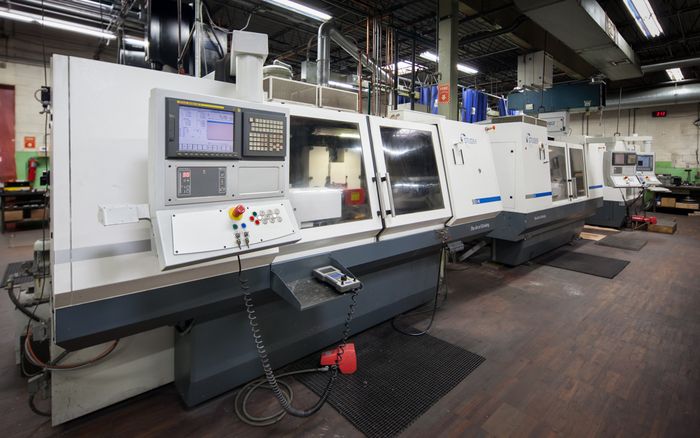

Since that first CNC machine purchase – a STUDER S40 capable of OD/ID grinding of parts up to 1,600 mm (63 inches) between centers – the shop has amassed an impressive collection of CNC grinders for cylindrical OD/ID, creepfeed, peel and surface grinding applications. All the machines have been brands now under the umbrella of United Grinding North America (Miamisburg, Ohio), and include STUDER, BLOHM and WALTER.
Damen’s first STUDER S40 featured all the bells and whistles, including wheel-indexing capability. The shop soon realized the machine’s flexibility and ease of programming, and it was quickly followed by two more S40s with the capacity to grind parts up to 1,000 mm (40 inches) between centers. Then came a STUDER S31 universal cylindrical grinder, followed by a STUDER S22 machine that was the first in the U.S. capable of peel grinding, Bachmeier said proudly.
Peel grinding uses a narrow wheel for efficient grinding of complex, small features in hard workpiece materials. The S22 can handle parts up to 800 mm (31.5 inches) between centers and features linear motor axis drives and a high-speed grinding option that allows circumferential speeds up to 140 m/s (460 fps).
Recently, two STUDER S33 OD/ID grinders joined the shop’s lineup. The universal cylindrical grinders sport a new control and wheelhead to enable grinding of complex workpiece geometries in single part clampings. The wheelhead features two motor spindles for external grinding and an internal grinding attachment.
The shop’s latest STUDER is a CT960 universal internal cylindrical grinding machine for ID and contour grinding. It is equipped with an interpolating B-axis that swivels to 91° and a four-spindle turret. The machine’s extreme versatility allows it to grind complex OD and ID geometries in single setups.

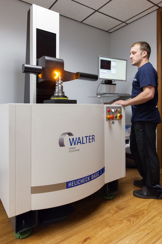

The shop’s passion for implementing the latest technology also extends to quality assurance. Damen uses a variety of in-process and post-process gauging equipment, including WALTER Helicheck machines and high-end coordinate measuring machines, to maintain its customers’ tight dimensional and surface finish requirements.
