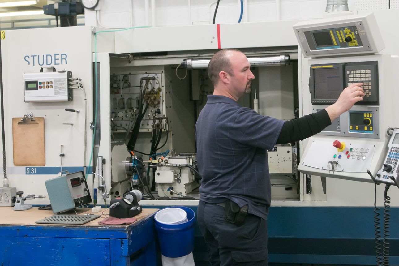

Copen Machine decided on a STUDER S22 CNC production cylindrical grinder from United Grinding North America, Inc. The machine offers a maximum grinding length of 800 mm and a center height of 175 mm.
“We kicked the tires and liked the fact that the machine was solidly constructed and fully enclosed,” said Copen. “The enclosure is optimal for automation. Parts can move in and out of the machine without having to open it. That capability increases process consistency, which is the key to successful unattended operations.”

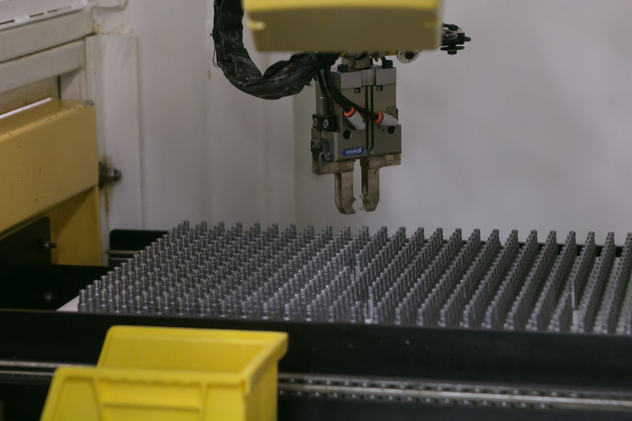

Copen Machine worked with robotic integrator Matrix Design for the S22 cell that consists of the grinder, a FANUC 100i robot and a gantry loader. The robot takes parts from manually racked trays and loads them onto the gantry that delivers the parts into the grinder.
“We needed the ability to load 1,000 parts at a time into the machine so it would be able to run for a significant number of hours,” Copen said. “The grinding and robotic loading process can be below 30 seconds per part. Our lot sizes for automated grinding range anywhere from 1,000 to 50,000 parts. For us, it’s not practical to set up an automated 100-piece run of basic O.D. ground parts.”

“We run parts that require we hold both tight overall tolerance as well as even tighter roundness tolerance. On top of that, they may have an interrupted grind surface,” Copen said. “To handle this, everything has to be right. It’s impossible to grind over a milled flat and hold 0.000050" part roundness unless you have a strong, solid machine. That’s why we went with STUDER grinders. Their mineral-casting Granitan bases are very rigid and provide optimum thermal stability. At 18,000 lbs., the machines just do not move.”

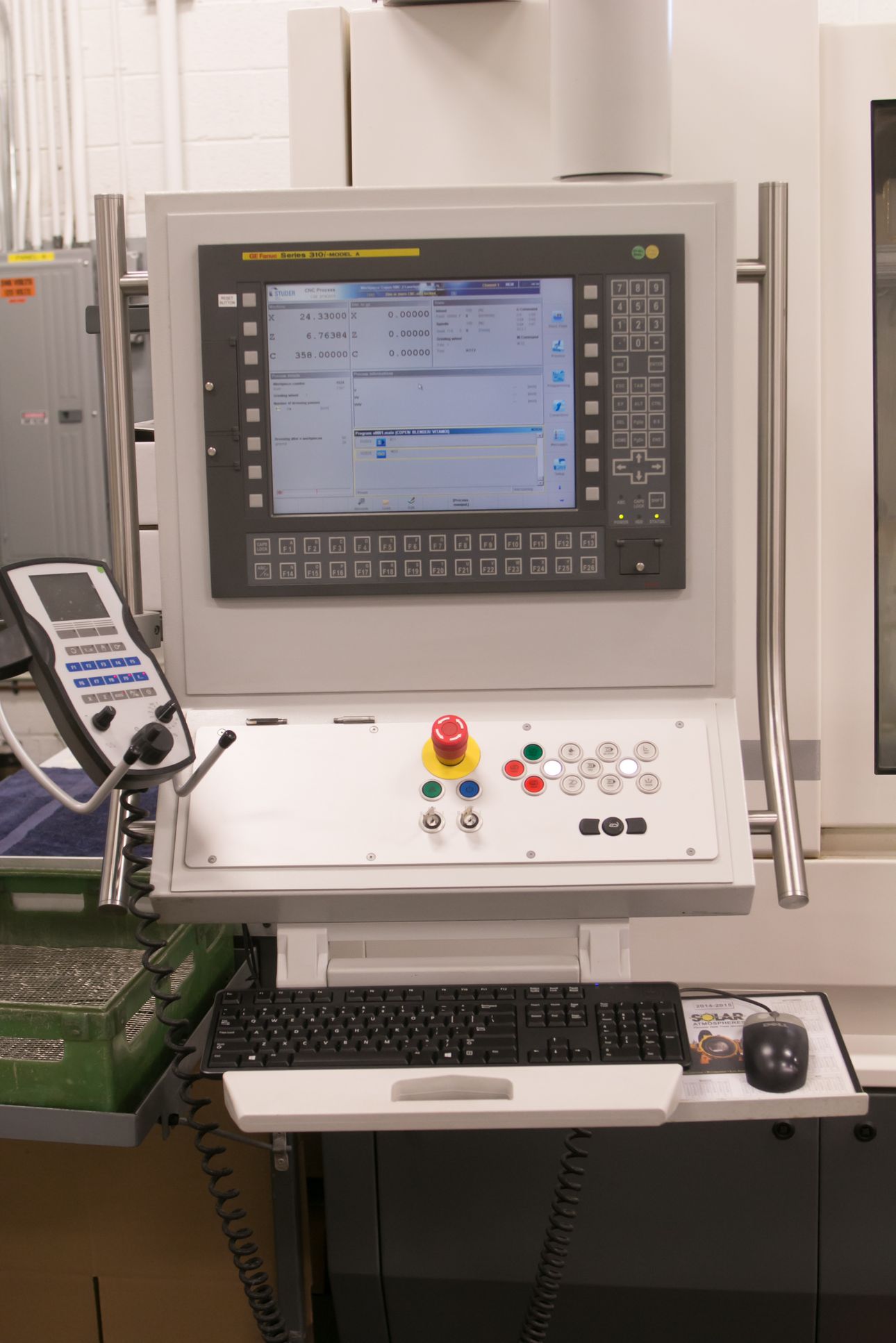

Once he has determined appropriate grinding and dressing parameters, Copen relies on Studer integrated software that provides grinding parameters, modules for wheel contact detection and automatic wheel balancing along with other functions that ensure trouble-free grinding. Additionally, the software aids in automated operations through monitoring of wheel wear and the condition of machine components. Because many of the parts that the company grinds are similar, Copen Machine stores, then slightly modifies grinding programs whenever possible to keep part changeovers typically well within two hours.
