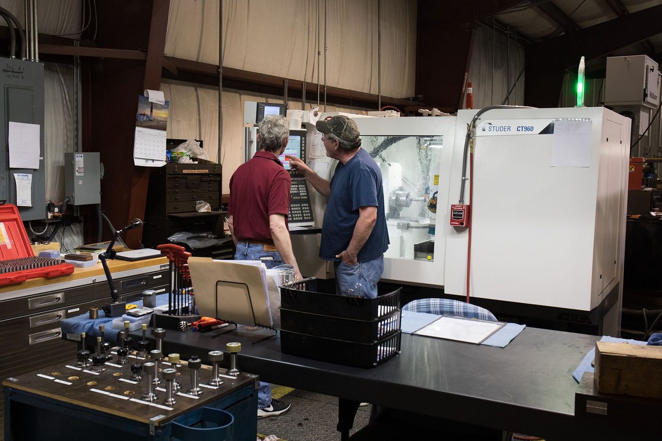

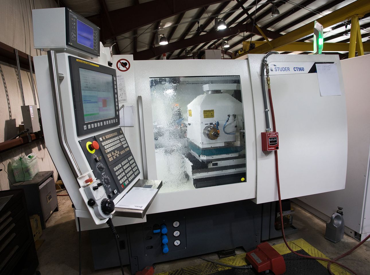

Bridge Tool & Die’s new CNC grinder is a Studer CT960 from United Grinding that does both ID and OD grinding. Its indexable head houses three ID spindles and one OD, plus a probe. The shop can run an operation, have the probe check the part and if needed tweak the program on-the-fly.
For Bridge Tool & Die, the Studer CT960 dramatically shortens setup times and most importantly eliminates the need to move parts between – in some instances as many as five – separate OD machines then to one that does ID grinding. Instead of these five individual setups on five different machines for one component, the Studer CT960 completes the part in a single setup.
For its wheels, the shop uses a variety of wheels ranging from metal bond to vitrified and those for finishing. Once wheels are qualified, part setups are even faster. Wheels can be loaded, unloaded and reloaded again and be in the exact location every time.
Many parts require small ID ground holes, which is why, according to Bridgman, the shop craves speed and gets it from the new Studer CT960. He explained that the smaller the grinding wheel and smaller the hole being ground, the higher the spindle speeds required. Higher speeds allow the small wheels to stiffen and grind even better, and for this, the machine delivers 42,000 rpm, 45,000 rpm and 60,000 rpm spindle speeds. The shop also has the option to boost its top speed to as fast as 90,000 rpm.
How the Studer CT960 turns feel into facts, according to Bridgman, is through its StuderGRIND software. It shows wheel position, spindle speeds and feeds and wheel pressure. Plus, it allows the shop to run simulations to avoid any problems during actual part runs. As a result, the software makes programming very easy and is user friendly.
