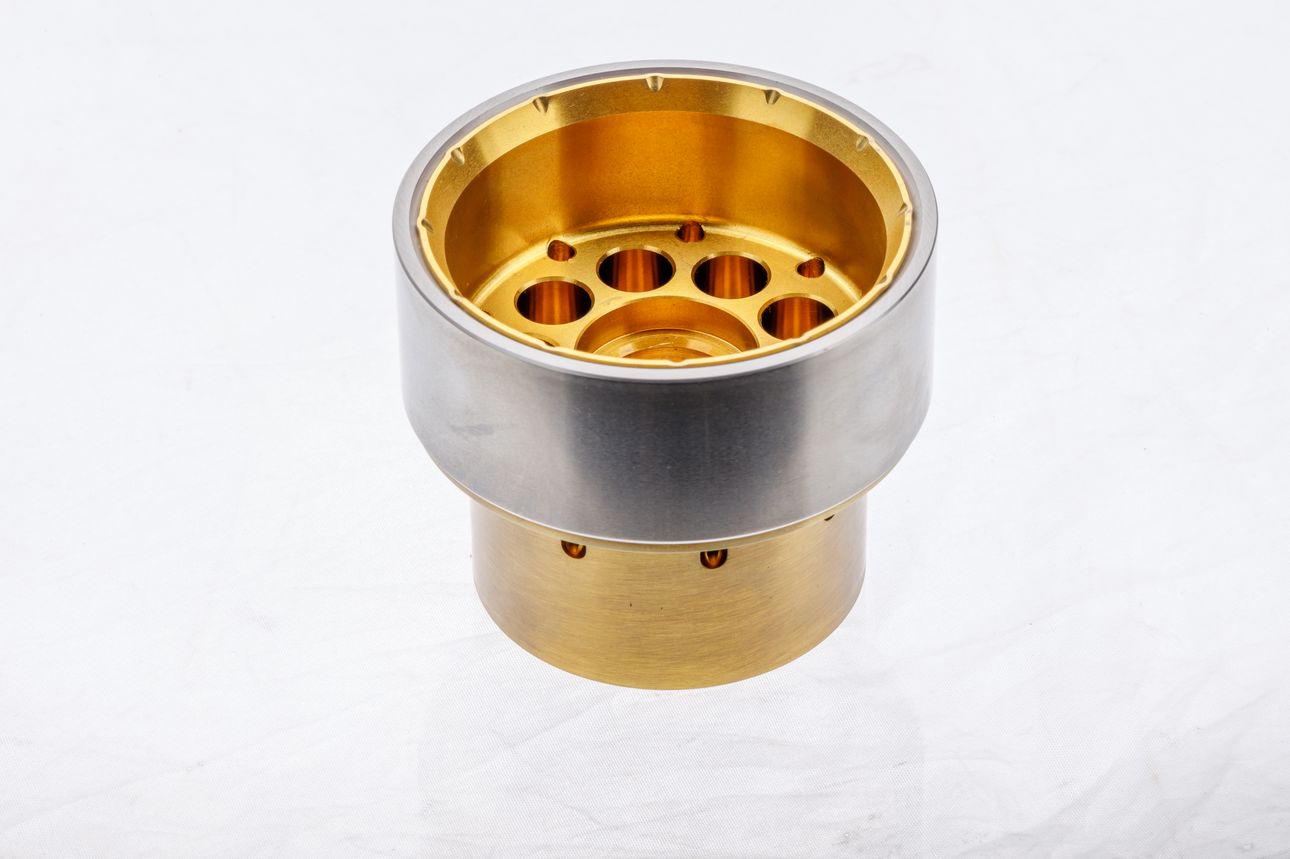

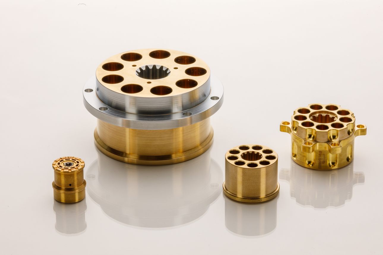

Among the critical aerospace assemblies C&S manufactures are hydraulic spool and sleeve valves, and Saratore said that the shop’s components are on nearly every airplane platform running today, both military and commercial. Typical workpiece materials are hardened 440C and 52100 aerospace steels and nitriding steels, in addition to the nickel-base alloys and titanium common in aerospace vehicles. “The parts generally are small enough to be held in one hand,” he added, “and we can often ship 20-40 pieces in a very small box.”

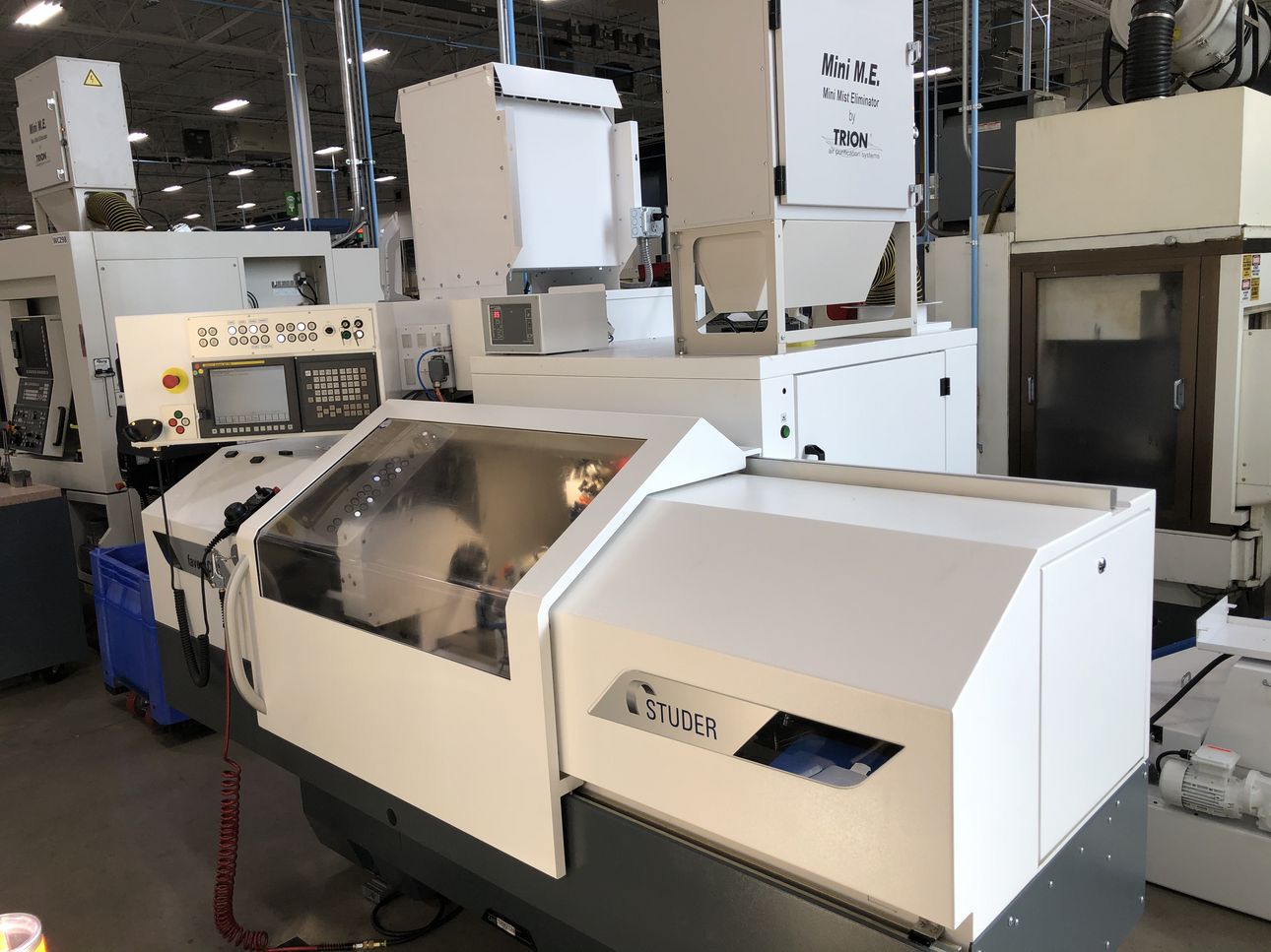

Within C&S’s lean manufacturing part processes, high-precision STUDER CNC grinders from UNITED GRINDING play a key role in helping to expedite production and reinforce quality. “United Grinding is our go-to grinding machine tool source that offers real depth in capabilities. It is a superior organization with superior grinders,” Saratore said.
Most of the shop’s STUDERs are favorit model machines that are engineered for cost-effective individual and batch production of workpieces up to 150kg (330lbs) in weight. The machines feature 8kW (10.7 hp) spindles that accommodate grinding wheels up to 508 mm (20") in diameter and 80 mm (3.1") in width. Center heights on the machines are 175mm (6.9") and, depending on the machine version, distance between centers is 400mm (15.7"), 650mm (25.6"), 1,000mm (40") or 1,600mm (63").
With various options such as in-process measuring system, balancing system, contact detection and longitudinal positioning, STUDER favorit machines can be adapted to other grinding tasks. Their bases are made of Granitan® S103, which contributes to their high-precision performance. For programming at C&S, the StuderPictogramming visual language allows less experienced users to quickly and practically program grinding and dressing cycles for the STUDER favorit machines.
“We use our STUDERs for cylindrical grinding,” Saratore said, “But we are also looking at other projects in the future, using different capabilities.” The shop installed a favorit machine a year ago, another a few months ago, and has another on order, for a total of eight.
