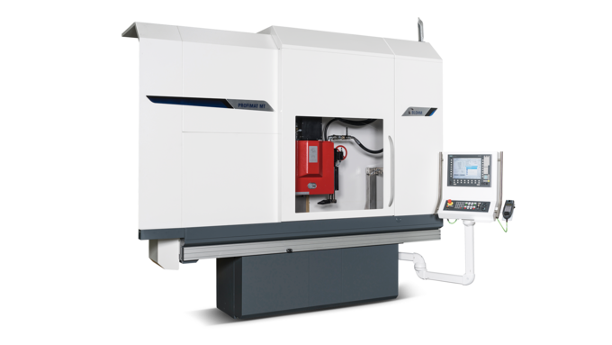

The benchmark for efficiency in profile grinding
PROFIMAT MT
In applications where the production process requires high stock removal rates, the flexible and powerful PROFIMAT MT is the right choice. A driving power of up to 60 kW and cutting speeds of 170 m/s guarantee maximum productivity – for both conventional and CD/IPD grinding processes, as well as for all high-speed grinding processes with CBN. Pretensioned anti-friction guideways in all machine axes guarantee the necessary system rigidity and reduce maintenance requirements.
The extremely efficient BLOHM software ensures exact interpolation of the axes and thus high workpiece quality. The scope of supply of the PROFIMAT MT comprises a Siemens Sinumerik 840 D control system with comprehensive operator prompting.
  • Modular system
  • High quality components made from gray cast iron
  • Thermal and vibration engineering characteristics optimized via finite
  • element calculation
  • Precision linear guideways
  • High quality, ground ball-type linear drives
