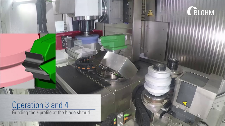

The PROKOS XT is the ideal grinding machine for the automated machining of complex workpieces. This multiple-axis grinding centre can also execute drilling and milling operations, in addition to grinding.
A special highlight: the unique SmartCAM software ensures complete CAD consistency, from the planning phase through to the NC program.
  • Complete machining in a single clamping
  • Significantly shorter processing times
  • Maximum productivity
  • Reduced thermal loading of the workpiece through speed stroke grinding
  • Tool changer with 24 positions
  • Collision testing through prior simulation (SmartCAM)
  • Can also be used as a fully automated cell with robot, loading, cleaning and measuring station

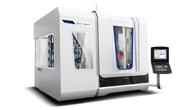

Max. Travel X 450 mm
Max. Travel Speed X 120000 mm/min
Max. Travel Y 450 mm
Max. Travel Speed Y 20000 mm/min
Max. Travel Z 900 mm
Max. Travel Speed Z 50000 mm/min
Max. Spindle Power 35 kW
Max. Number Of Revolutions 12000 /min
Max. Grinding Wheel Diameter 300 mm
Max. Grinding Wheel Width 50 mm
Swiveling Range A 130 °
Swiveling Range B 360 °
Table Sizes 300 x 300 mm
