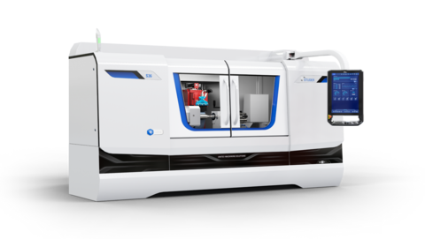

The super-productive machine for small workpieces.
The S11 is a production cylindrical grinding machine for small workpieces. It has a distance between centres of 200mm (7.9") and a centre height of 125mm (4.9"). It can machine workpieces with a maximum weight of 3kg (6.6lbs).
The production cylindrical grinding machine can be precisely tailored to the desired process. Highly dynamic axis drives, high-quality STUDER guideway systems, short reaction times and optimized traverses form the basis of the S11. The high-speed grinding option (HSG) contributes to increasing productivity with its peripheral speed of up to 140m/s (27,600 sfpm). With a floorspace requirement of less than 1.8m2 (19.4sqft), it is extremely compact and will fit in any workshop.
  • Grinding wheel arrangement 0° or 20°
  • Grinding wheel right dia. 500 x 63 x 203 mm (20" x 2.5" x 8")
  • Two full enclosure variants:
    - With large door opening, ideal for manual loading or small loader systems
    - With loading hatch for top loading, especially suitable for the interconnection of several machines
  • Dual axis cover (telescopic and bellows)
  • Granitan® S103 mineral casting machine base
  • PCT touchscreen (Projective Capacitive Touch)
  • Easy programming with the new operator interface StuderWINfocus on the Fanuc 0i-TF
  • Simple and clear process visualization
  • Software optimized for touchscreen
  • In-process gauging software integrated into the machine control
  • StuderWIN programming software for producing grinding and
    dressing programs on a PC
  • StuderGRIND programming software for the creation of grinding and dressing programs directly on the machine control, or on an external PC
