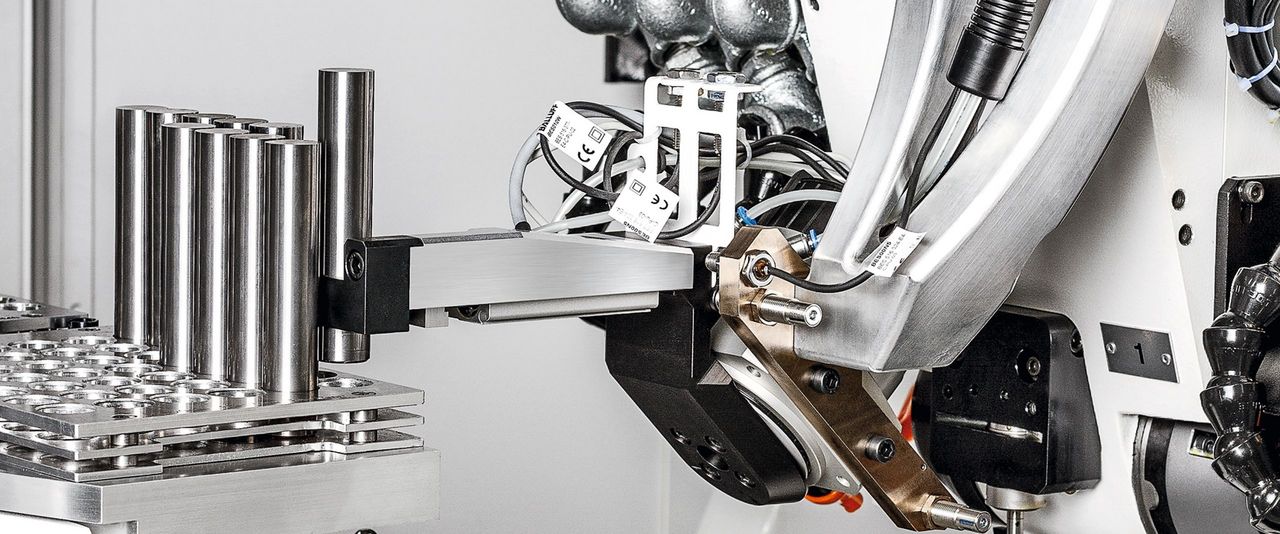

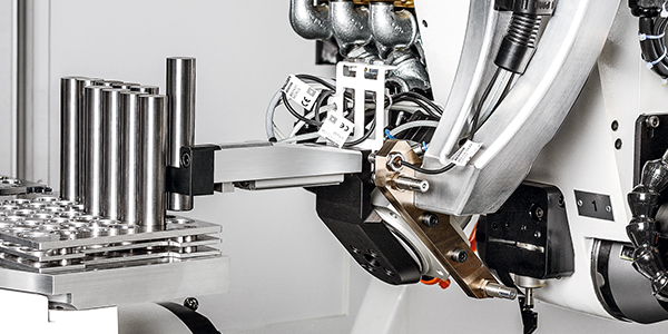

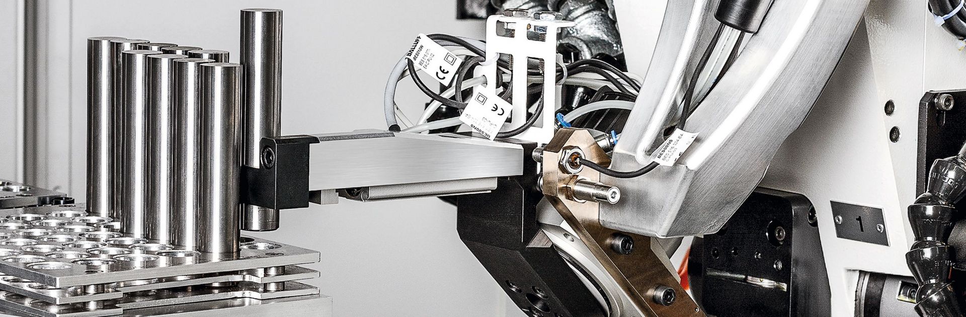

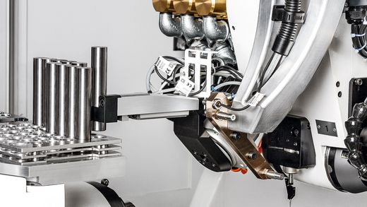

WALTER machines pair with robot loaders and top loaders. Top loaders pair with just about every machine we make except the COMPACT (which already has a loader built-in). Robot loaders are available on our VISION and POWER machines.
- Robot Loader: High capacity for tools it can fit in its 3-tiered pallet system. Each pallet is a tray with holes in it. You fill a tray with carbide blanks and designate another tray where the robot can put finished tools.
- Robot Loader 25: Similar to the standard robot loader, except it allows the robot to handle heavier parts. And, importantly, it has HSK 25 workholding instead of collet-style clamping.
- Top Loader: For smaller-batch production and smaller floorspace footprints since the loader stacks right on top of the WALTER machine. Ideal for squeezing in one more run during lunch, at the end of the day or whenever you have a bit of time.

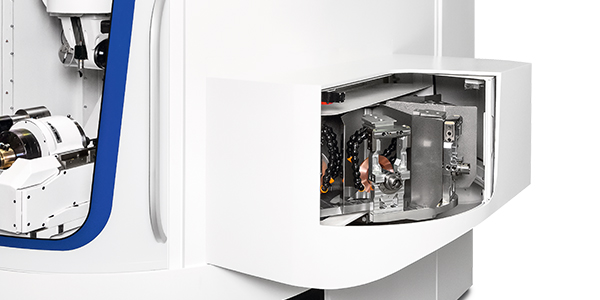

TOOL CHANGERS
Tool changers are great if you require super complex geometries in your cutting tools, or for lights out high production runs. The larger wheel changing capacity allows you to go through a magazine of grinding wheels and call up the one you need for that particular part.

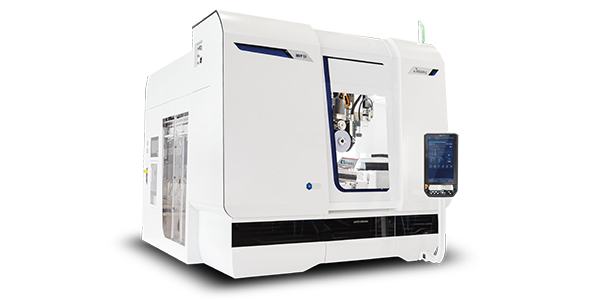

For the first time, a BLOHM PROFIMAT machine has tool changer integration. The PROFIMAT XT has room for an 8-pocket magazine for grinding wheels. If you’re doing a profile grind with various features or forms you can’t get with a single wheel, the tool changer lets you avoid dressing a new form for every feature or doing multiple runs. The machine can go in, grab the wheel, and get the part done in a single clamping.
The MÄGERLE MFP 30 and MFP 51 have tool changers that add on to the back of the machine as well. It’s a thing of beauty to see 5-axis combination machining get done, with grinding, milling, drilling and probing in a single clamping.
