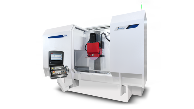

MFP Series - The Long-Distance Machine
With the MFP series, Mägerle comprehensively covers the requirements for flat and profile grinding machines. These machines specialize in creep feed grinding as well as profile and flat grinding operations using the pendulum method. They demonstrate their full performance potential in applications where workpieces must be produced in large batches and with high stock removal volumes in the customary high Mägerle precision. Thanks to their robust construction, the machines in the MFP series also master these requirements in hard 24/7 continuous operation. The Mägerle MFP series has a modular design. Table lengths and vertical strokes across a large range can be freely combined with different additional axes and special components.
This flexible modular system enables diverse machine configurations, which are precisely geared to the specific user requirements.
  • High removal volume with high precision
  • Demanding continuous operation 24/7
  • Modular system for different table sizes and vertical strokes
  • Configurable (user-specific)
  • Optional additional spindle/swiveling spindle
