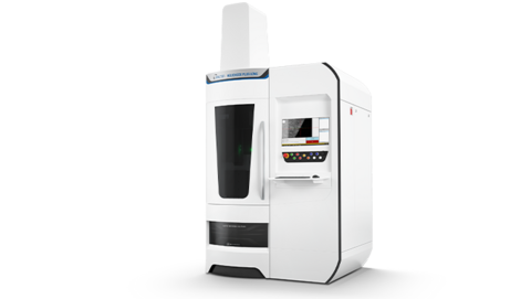

![HELICHECK NANO HELICHECK NANO](https://cdn.grinding.com/fileadmin/content_live_2019/www.walter-machines.com/00_pic/03_machines/3_Measuring/HELICHECK-NANO/walter-machines-helicheck-nano-measuring-machine-680x363.png)
For the fully automatic complete measurement of complex geometries, the HELICHECK NANO CNC measuring machine in the micro and nano range is the ideal solution. Thanks to the microscopic sensor technology, even the smallest geometries can be reliably recorded and evaluated - from a diameter of 0.1 mm. In the range up to 16 mm diameter, the HELICHECK NANO shows its strengths to the full. With certified accuracy, it sets standards for ensuring productivity, quality and precision in modern tool production. In automated tool machining, it assumes the key function of "quality control" with integrated tolerance compensation in the process.
Fully automatic - operator-independent - completely comprehensive.
