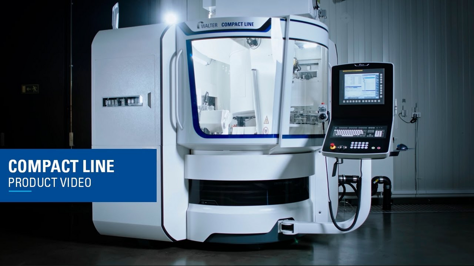

The COMPACT LINE CNC tool grinder has six CNC axes. The tool grinding machine is used for the production of indexable inserts, including burring, milling, lathing and profile plates. A variety of clamping systems, docked to the machine via a plug & play interface, offer complete freedom in the choice of tools, sequence and lot size. Thanks to extremely low set-up times, very small batches can also be produced economically.
