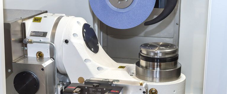

In the milling vs. grinding debate, a truth has emerged: creep feed grinding is a more efficient approach for deep cuts than using a CNC milling machine. Let’s look at how the emergence of creep feed grinding and other innovations have impacted things.
Grinding Machines Follow a Done-in-One Mantra
Machine manufacturers have adopted a “done-in-one” approach with their machine technology, adding capabilities to make machines easier to program, reduce work-in-process changes, allow processes to be combined and increase the value per operation. Many grinding machines now have built-in automatic wheel changers and dressing units, which allow for several gradations of grinding in one clamping.
The greatest benefit of continuous dress creep feed grinding (CDCF) may be in undoing the traditional elongated process of milling, heat treatment, deburring and finishing by combining those applications into one operation.
In some cases, creep feed grinding is as much as 40 percent faster than alternative processes for cycle time while providing improved surface finish quality. If a turning or milling operation still needs grinding, why not just grind from the start?
Grinding Offers Many Benefits Over a CNC Milling Machine
Creep feed grinding has such promise because of its high MRR, which is increasingly important as many industries adopt harder materials for better-quality parts. While traditional reciprocating grinding processes remove small amounts of material with feed rates around 200 ipm, a single pass in creep feed grinding is in the range of 2–20 ipm at depths of cut of 0.100" to 1.5" or deeper.
Creep feed uses a heavier grinding depth and a slower traverse rate, which cannot be matched by milling for harder materials. The deeper cut of the wheel is a high force, but the low traverse rate benefits wheel life and power efficiency.
