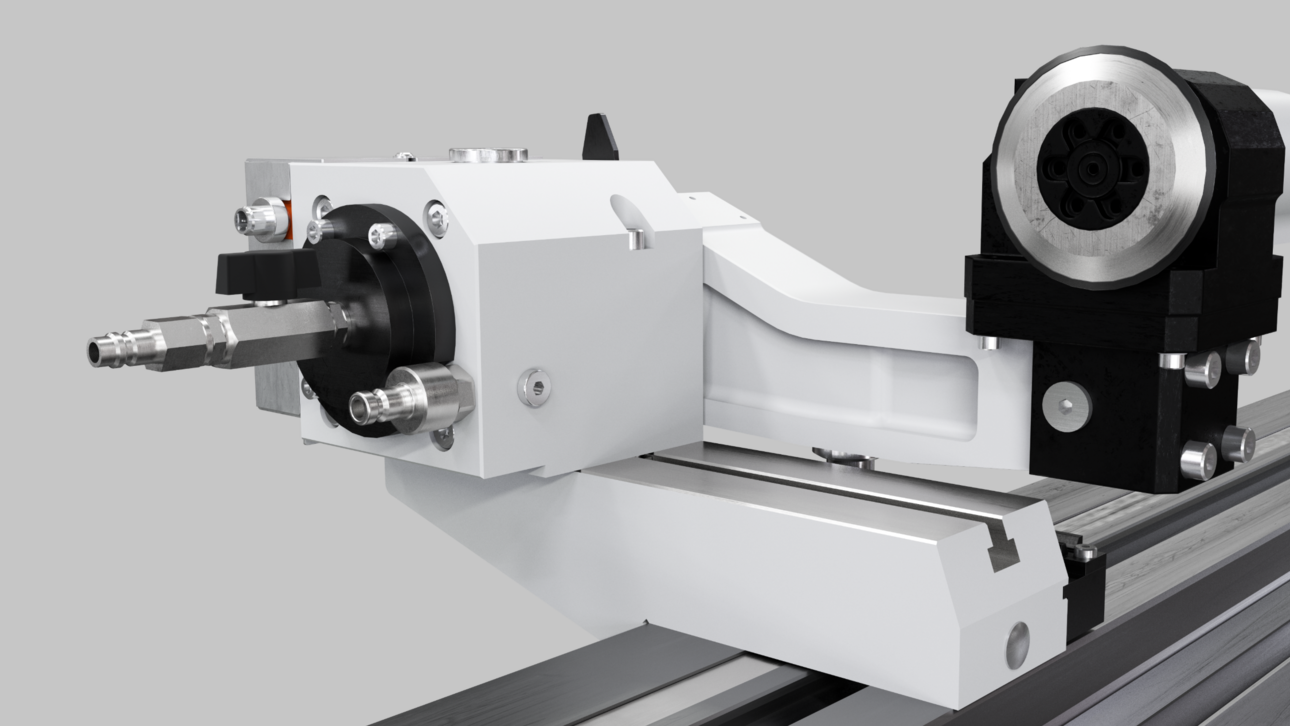

- Selectable wheelhead:
- Fixed wheelhead, adjustable 0°/15°/30°
- Universal wheelhead, Hirth 2.5°, manual
- Universal wheelhead, Hirth 1°, automatic
- Up to three grinding tools selectable
- Frequency-controlled belt-driven or motor spindles available
- External and internal grinding possible in one setup
- C-axis for out-of-round and thread grinding
- Fixed table or swiveling table (up to 8.5°)
- Portable control unit for setup close to the grinding process
- Automatic operating door
- Granitan® S103 mineral-cast machine base
- Very simple programming thanks to StuderPictogramming
- Reduced set-up and resetting times with STUDER QuickSet
- Flexibly upgradeable with integrated software modules
- StuderWIN programming software (optional) for creating grinding and dressing
programs on an external PC
