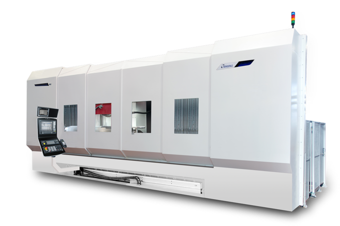

Mägerle MGC with stationary workpiece carrier – The heavy worker
The MGC grinding centre with stationary table is designed for the high-precision processing of large and heavy workpieces. With a broad range of different table sizes and vertical strokes, this machine meets the highest requirements in respect of load bearing capacity.
Like all models in the MGC series, this grinding centre is also based on the proven modular concept. Thanks to its variety of configurations with one or several spindles in a horizontal or vertical arrangement as well as a multitude of additional components, the MGC with fixed console is also one of the front-runners in its category with regard to flexibility.
