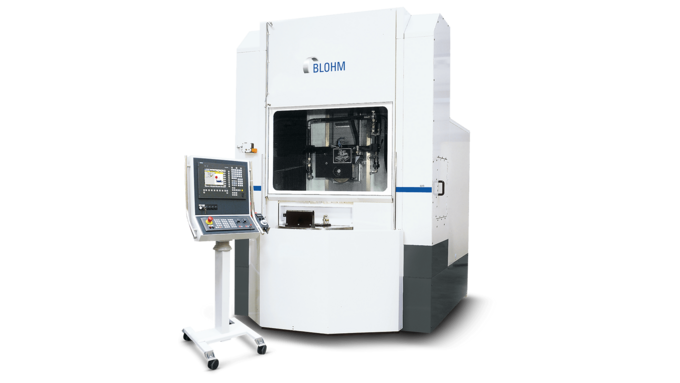

Are you looking for a grinding solution for the production of large lot sizes or batch production? Then the PROFIMAT RT could be the right machine for you. This highly efficient production machine with a traveling column design is equipped with a rotary indexing table. This enables workpiece handling in parallel with the primary processing time, i.e. continuous, simultaneous loading and unloading during the grinding process. Low setup costs combined with high efficiency and the possibility of simple adaptation of automatic workpiece change systems set benchmarks in modern and cost-effective production.
With a maximum spindle power of 60 kW and a cutting speed of up to 170 m/s, the RT is ideally suited for both conventional grinding and for CD, IPD and all CBN grinding processes.
- Rotary indexing table diameter 1,000 mm
- Traveling column design
- Rigid machine structure thanks to generous guide spacings
- High infeed speeds and accelerations
