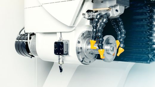

A visual inspection of exposed machine parts by an experienced technician provides a lot of actionable information right away. Conditions that may be worsening can be caught and remedied early, before addressing them becomes exorbitantly expensive if they are neglected. The process typically begins with measuring the amount of backlash and deflection on each axis to determine if the measurement is within specification or beginning to show signs of wear.
Taking Control of Machine Geometry Health
Over time, grinding machine geometry becomes compromised when free movement, or backlash, can be measured that varies from factory clearances and design tolerances. Any out-of-spec gaps between parts will interfere with the precision of the machine’s operation. Thus, running a machine geometry check is a central element of grinding machine PM. Following is a description of what this entails:
Condition of the work piece carrier’s runout.
What is tested: Technician determines concentricity of the holder and checks the runout in the test bar of the A-axis. High runout translates into wobbling tools, index issues, and other tool finish problems.
Parallelism of the A-axis to the X-axis.
What is tested: Technician uses a test arbor to check the geometry of A in reference to X and adjust the zero point and centerline when necessary.
Parallelism of the Z-axis.
What is tested: Technician checks the parallelism of the Z-axis with a granite block, removing one of the shoes in the guide rails to check its condition, preload and backlash. A common root cause for an out-of-alignment Z-axis is bad rails.
Perpendicularity of the Y-axis to the upper plate.
What is tested: Technician checks and can make adjustments in the tool program if the Y-axis leans forward when the Z-axis rails are worn.
Perpendicularity of the grinding head to the upper plate.
What is tested: To avoid premature wear of ball screws, the technician straightens the Y casting position in the rails.
