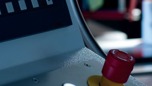

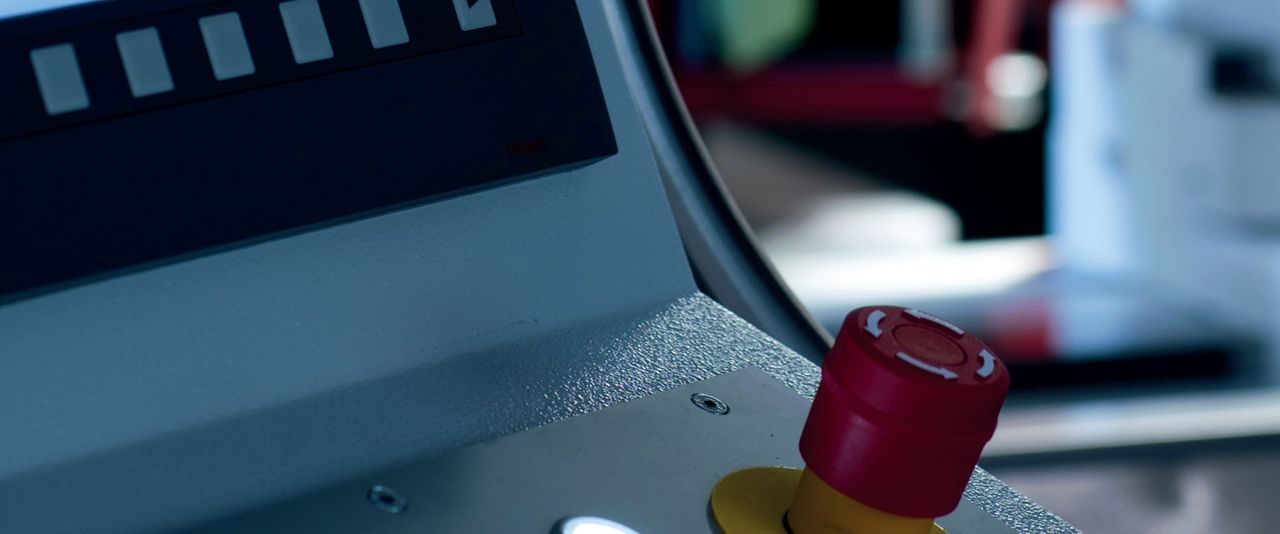

5. There’s more than one E-stop button
Everyone remembers the big E-stop button, but there are all kinds of diminutive buttons on the handheld, and E-stop is one of them. Be sure that all E-stop buttons are released.
