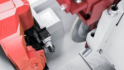

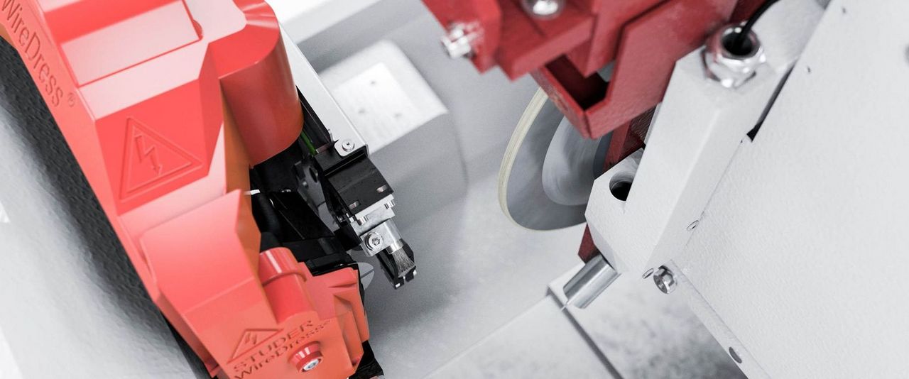

For this, manufacturers turn to STUDER WireDress® and its ability to handle the toughest metal-sintered wheels. Profiling and sharpening occur automatically through a process akin to wire electrical discharge machining (EDM), which requires no mechanical contact between the wire, the grain and the bond, thus protecting the abrasive grain. And thanks to the advanced design of the WireDress® system, manufacturers can obtain the highest degree of productivity, precision and ease of use.
WireDress® allows for the use of metal-bonded wheels, a factor that accounts for more than 30% greater power than ceramic bonding on its own. These wheels last longer, manage heat better and cut cleaner, faster and more aggressively than vitrified or resin-bond wheels. The WireDress® erosion process accentuates such performance through sharper, more precise and effective wheel dressings, all performed inside the grinding machine itself and while grinding wheels rotate at actual working speeds.
For high-performance alloy grinding efficiency, dressing at full wheel speed eliminates problems and inaccuracies from wheel growth. Full-speed dressing, along with the pinpoint accuracy of the erosion process, makes it possible for the STUDER WireDress® to generate exacting geometries. Users simply enter a wheel’s profile information into the grinding machine’s CNC using existing standard UNITED GRINDING StuderDress software to automatically calculate dressing programs for any particular wheel profile.
