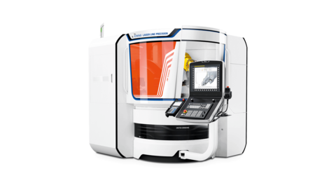

VISION LASER offers state-of-the-art laser processing for brazed diamond tools – developed for maximum precision and efficiency in tool production. Based on the proven HELITRONIC VISION, the machine combines decades of experience with pioneering laser technology.
Thanks to the innovative C.O.R.E. operating system, you benefit from intuitive operation, seamlessly integrated system applications and a fully digital workflow – standardised on all machines from the UNITED GRINDING Group.

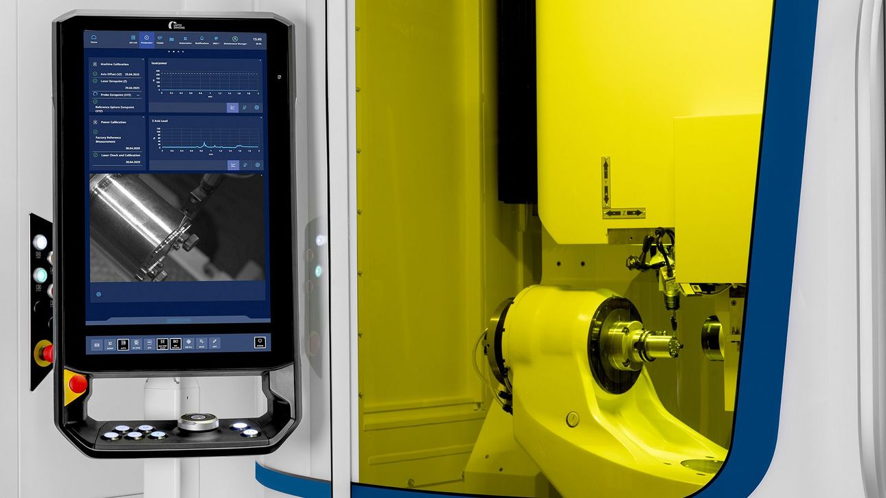

Automatic calibration
Precision made easy. Automatic calibration of the axes, the laser focus position, and the center of rotation minimizes operator effort and enables highly precise and efficient manufacturing processes.

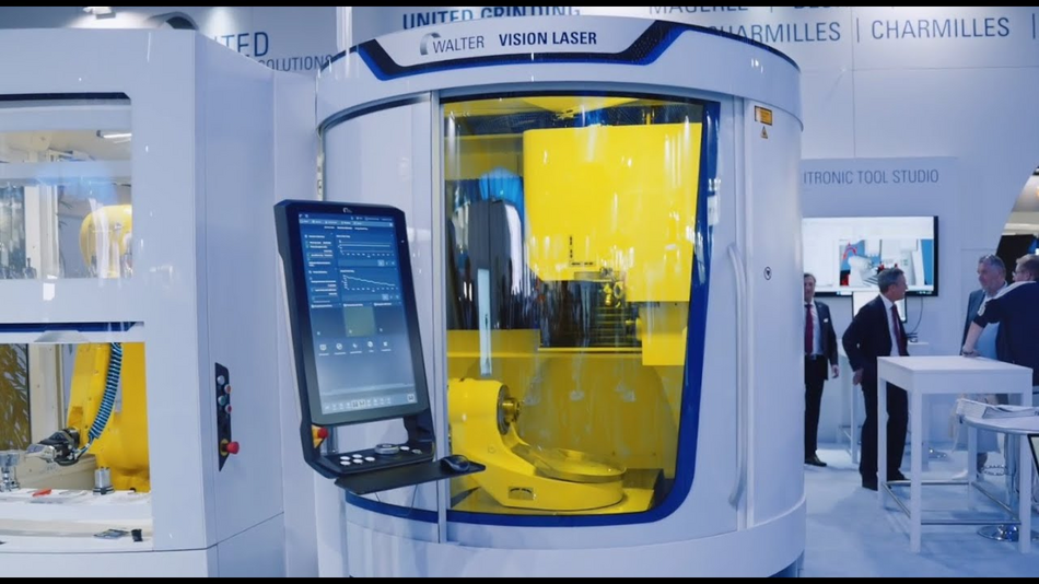

Software integration and user-friendly operation
The GTR ProfDia Laser software is used as a classic application similar to the GTR ProfDia Erosion, which has been widely used in wire erosion for decades and thus offers GTR-experienced users an easy introduction to operating the new laser machine.

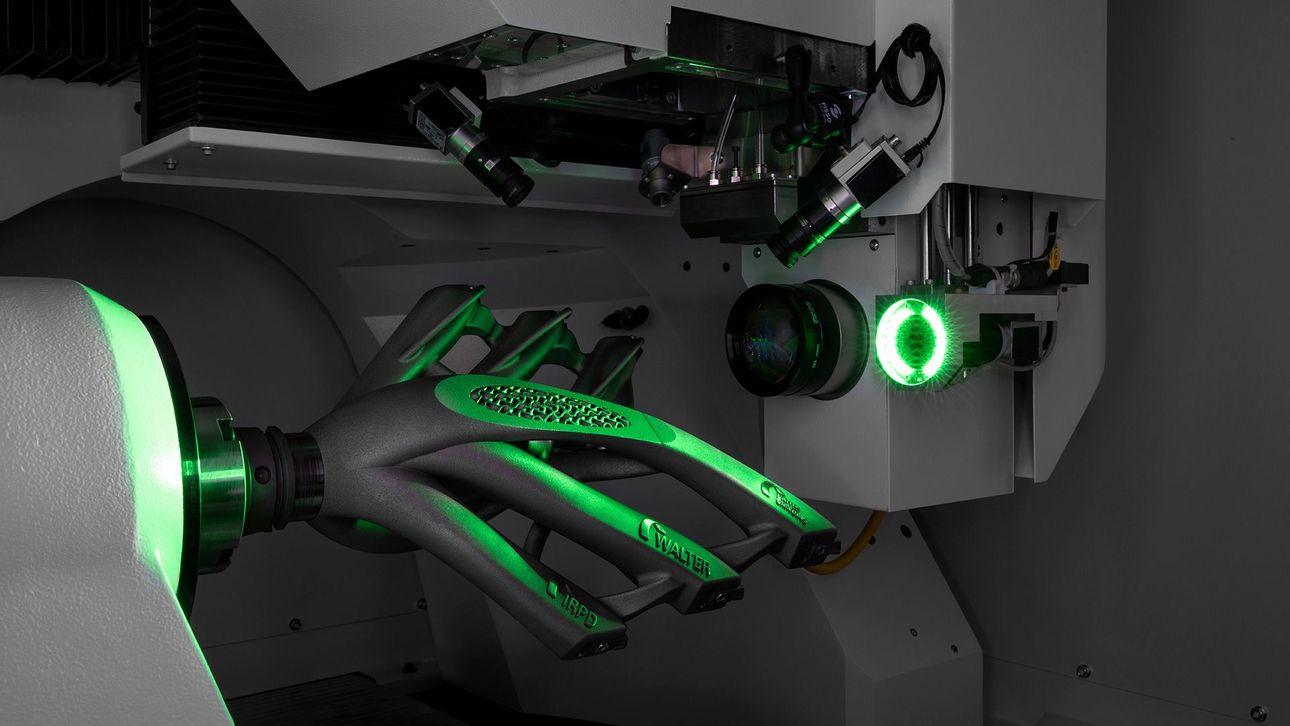

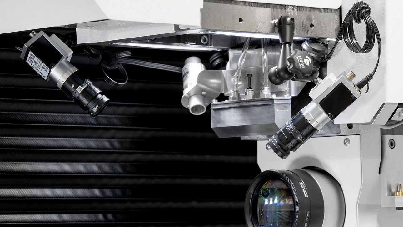

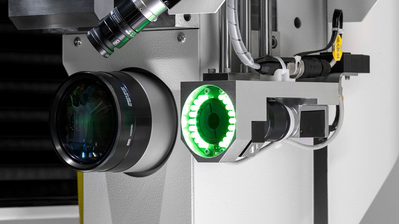

Live process cameras (optional)
Für das Einmessen der Rohlinge und für die Überwachung der Bearbeitung sind optional drei Kameras verfügbar, die den Bearbeitungsprozess in einer Übersicht oder einzeln im Vollbildmodus anzeigen können.
