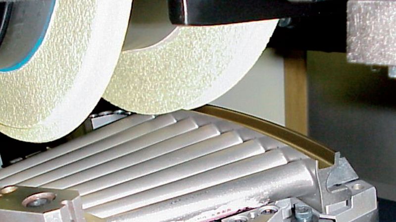

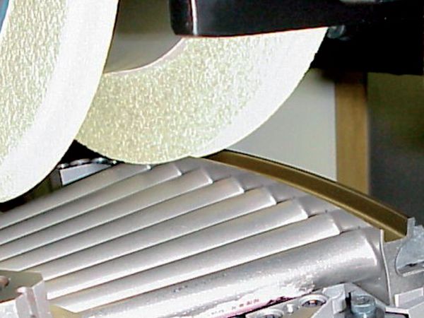

Creep Feed Grinding
  • Does your application require significant removal of hard materials? It’s time to consider creep feed grinding.
  • Much faster than traditional surface griding. Similar depths of cut and MRR compared to milling—without sacrificing surface finish

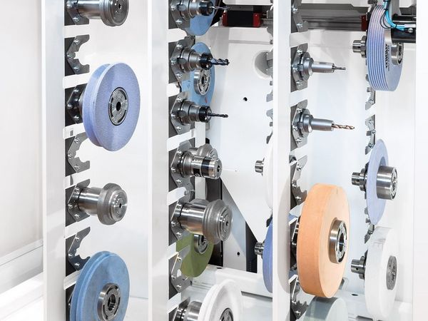

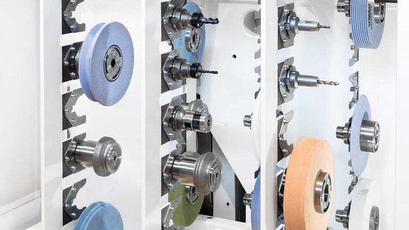

Multi-Tasking Operations
  • Uses automatic tool changes, expandable tool magazines, powerful spindles and modular machine designs to provide wildly flexible capability
  • Ideal for shops who can no longer afford long changeovers, risky manual setups or less-than-ideal repeatability
  • Look closer at the BLOHM PROFIMAT MC or the MÄGERLE MFP 100
Learn More

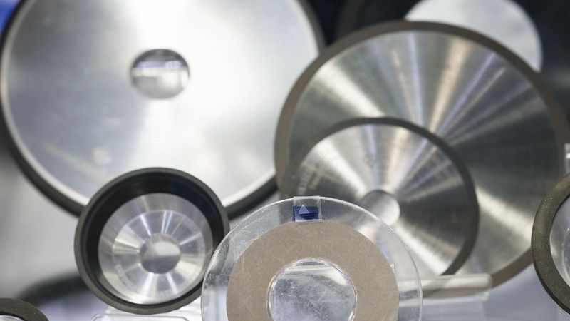

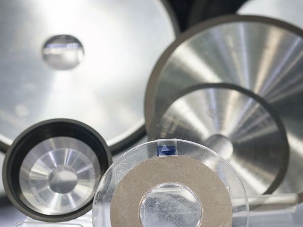

Superabrasive Grinding
  • Impressive surface and profile machines equipped with superabrasive grinding tech like CBN wheels
  • Better MRR, heat management and wheel life for advanced materials and superalloys
  • Look closer at the BLOHM PROFIMAT Series or the MÄGERLE MFP Series
Learn More

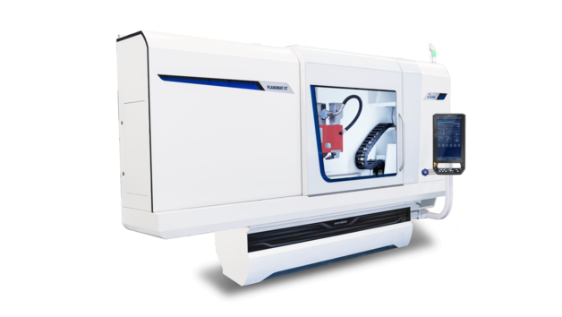

Surface Grinding
  • A common application that happens to be difficult to do at an elite level
  • Applications that require high surface grinding precision include rolling dies, machine tool fixtures and turbine blades
  • Look closer at the BLOHM PROFIMAT MT, MÄGERLE MFP 100 and JUNG J600
Learn More

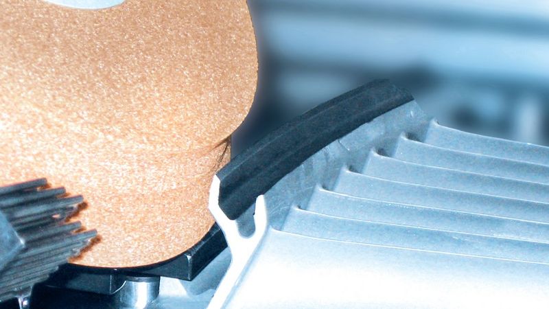

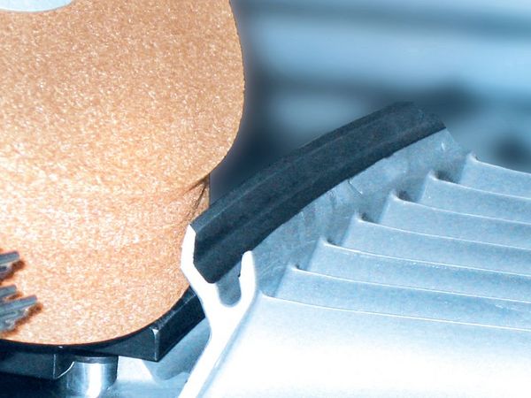

Profile Grinding
  • Industries like automotive, aerospace, machine tool, hydraulics, semiconductors and die and mold demand high-precision profiled parts
  • Unbeatable levels of efficiency and accuracy
  • Look closer at virtually any machine in the BLOHM, MÄGERLE and JUNG lineups
Learn More

For complex shapes and surfaces, an accurate form can be ground using a properly shaped grinding wheel. There are a few options:
  • Form dressing: Using a DXF file, a single point rotary disc dresser generates a precise form in the grinding wheel via a two-axis CNC contour dressing operation. Alternately, a full-form diamond roll can generate the desired grinding wheel form.
  • Exact shape grinding wheel: Grinding wheel manufacturers can create superabrasive grinding wheels to custom shapes and sizes.
Additionally, path grinding can generate complex forms. For more complex shapes and surfaces, a grinding machine with multi-axis capabilities is needed. These additional axes could come in the form of a rotary table, a moving column or both.

Yes, many of the surface and profile grinding machines at UNITED GRINDING have options for milling, drilling and other machining operations. These machines integrate high precision HSK spindles with automatic tool changers and large tool magazines, and can accommodate cutting tools and measuring probes clamped in industry-standard HSK tool holders.
By combining these additional machining processes together with finish grinding operations in a single clamping, manufacturers can achieve a number of operational benefits. Parts completed in a single setup (rather than on multiple machines) benefit from improved precision and repeatability. Eliminating additional part clampings also reduces processing time, gets parts to customers faster and improves the bottom line.
