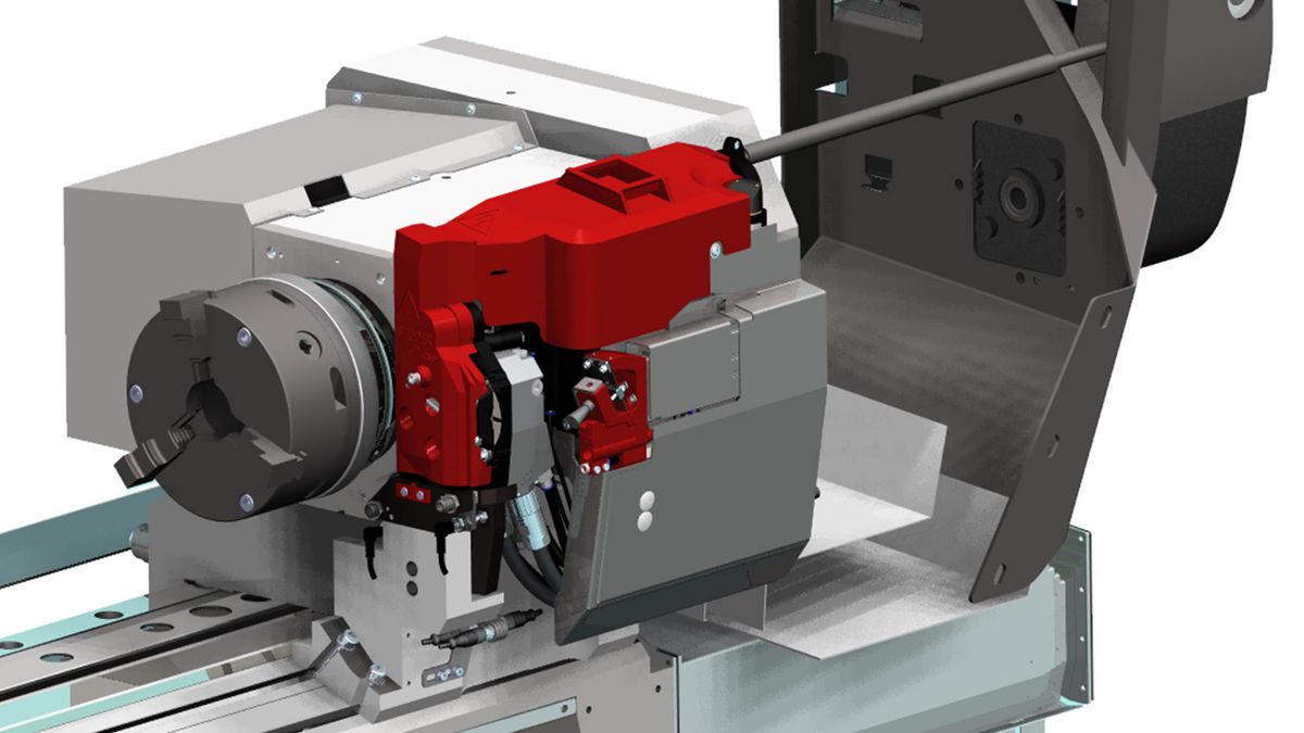

With WireDress® STUDER brings a brand new dressing device to the market, which is completely integrated into the cylindrical grinding machine and its control system. Laborious dismounting and resetting of the grinding wheel during reassembly after external dressing is no longer necessary.
STUDER WireDress®
With the new STUDER-WireDress® dressing technology, metal-bonded grinding wheels can now be conveniently dressed, i.e. profiled and sharpened, with maximum precision in the grinding machine, at full working speed. In addition, the grinding wheel receives a high level of cutting with high grain clearance. WireDress® is available as a dresser option on the STUDER S22 and S41 cylindrical grinding machines.

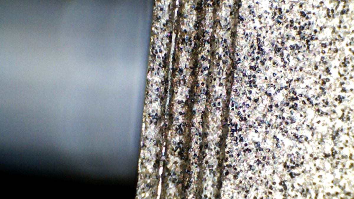

D64 Scheibe mit kleinen Nuten

  • Highest grain clearance> max. sleekness
