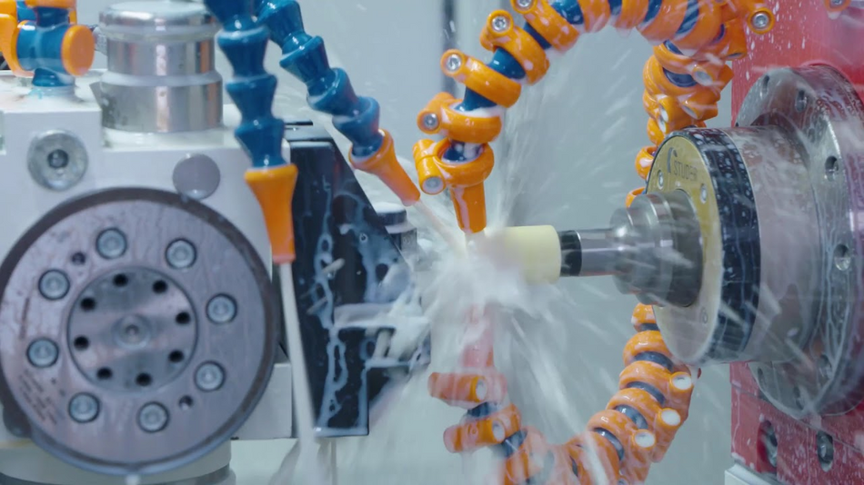

The S131 is a radius internal cylindrical grinding machine that is especially suitable for grinding complex workpieces from very hard materials The maximum swing diameter is 300mm (11.7") and the maximum workpiece weight is 100kg (220lbs).
The machine is ideal for the manufacture of drawing dies, especially in the packaging industry, where tungsten carbide and ceramics are primarily processed. The machine has a host of sophisticated technical features such as the revolutionary StuderGuide® guideway system, high-precision axis drives with linear motors, a fully automatic B-axis with direct drive, etc.
  • Fully automatic workpiece swivel axis with direct drive and simultaneous interpolation with the X and Z axis. Swiveling range of -60° to +91°
  • Wheelhead can be configured with up to four grinding spindles
  • Frequency-controlled motor grinding spindles for external and internal grinding
  • Precise C axis on the workhead spindle for form and thread grinding
  • C.O.R.E. Panel
  • Portable control unit (PCU) for setting up close to the grinding process
  • Full enclosure with two sliding doors
  • StuderGuide® guideway system with linear drive
  • Granitan® S103 mineral-cast machine base
  • C.O.R.E. OS operating system
  • Simple operation and programming thanks to StuderSIM
  • StuderSIM programming and simulation software for creating and simulating grinding and dressing programs on the machine control or on an external PC
  • Standardized interfaces for loader and peripheral units
