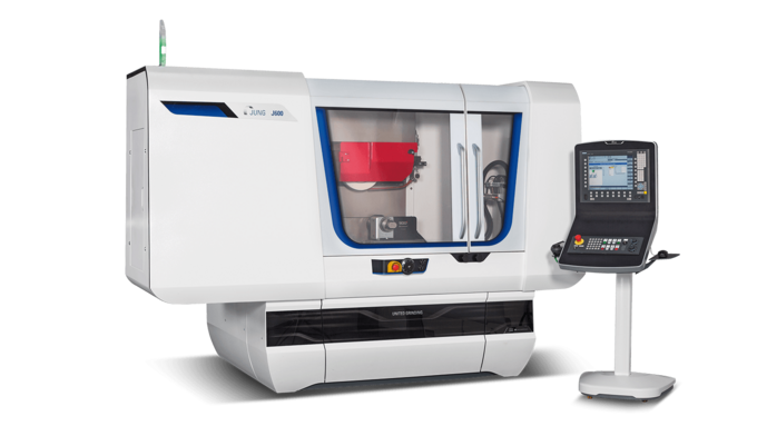

A modern flat and profiling machine for high precision and surface finish – this presents JUNG with the new J600.
This machine offers a host of potential applications - from individual component production through to small batch production in all industries. With its grinding range of 300 x 600 mm the J600 realizes its full potential particularly when grinding demanding applications in tool and die making.
The J600 offers a unique ease of use. The double sliding door to the work area and additional maintenance doors guarantee optimal handling and cleaning of the machine.
The J600 opens up new potential applications through its Polygon grinding software add-on.
  • All important elements are made from gray cast iron
  • Proven cross-slide design
  • X-axis with hydrodynamic EasySlide guideway
  • Additional electronic handwheel in the area of the
  • work area door for the X, Y and Z-axis
  • Polygon grinding
  • Head-mounted dresser PA-K37
