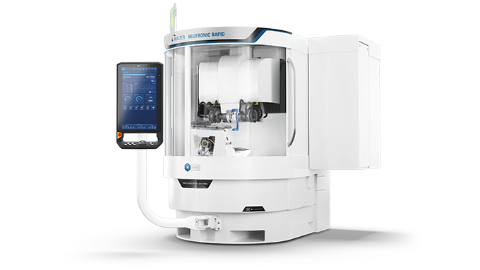

The HELITRONIC RAPID tool grinding machine with C.O.R.E. technology is a tool grinding machine with 5 CNC-controlled axes specially designed for the resharpening and production of milling cutters, drills, step drills, step tools, woodworking tools, profile knives and profile tools.
Diameter range 1 to 16 mm for production and 3 to 100 mm for resharpening, machining length up to 255 mm, unit weight up to 30 kg.
Optionally with
- Top loader
- Glass scales
- A-axis torque motor
Features
Top loader automation option
This space-saving and inexpensive automation solution is integrated directly into the machine envelope of the HELITRONIC RAPID. Automatic teaching enables short setup times. Depending on the tool diameter, the Top loader offers a maximum of 500 places for tools.
Glass scales (option)
Automatic & highly accurate position measuring system for all linear axes
Fast-rotating A-axis (option)
Torque motor adjustable from 0 to 1,000 rpm
