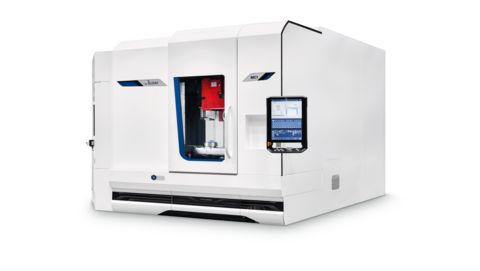

BLOHM designed the MC5 as a versatile grinding center for precision and profile grinding in a single machine. With its moving column concept, 5-axis flexibility and spindle speeds up to 8,000 min-1, it handles a wide range of workpieces, from turbine components to precision tooling.
The all-abrasive technology approach allows the best cutting technology to be used for every dedicated part. Linear guideways and direct measuring scales on all axes ensure highest accuracy, while pre-programmed grinding and dressing cycles keep setup and changeover times to a minimum.
The MC5’s compact footprint delivers maximum productivity per square meter, making it your efficient solution for flexible grinding production.
    • Moving column concept
    • Linear guideways and direct measuring scales for all axes
    • Grinding wheel size up to 400 mm
    • Spindle power: 27.5 kW
    • Spindle speeds up to 8,000 min-1
    • 5-axis system
    • C.O.R.E. panel
    • Pre-programmed grinding and dressing cycles
    • Intuitive operation
    • Focus on work and production safety
    • CAD/CAM connection
    • C.O.R.E. operating system
