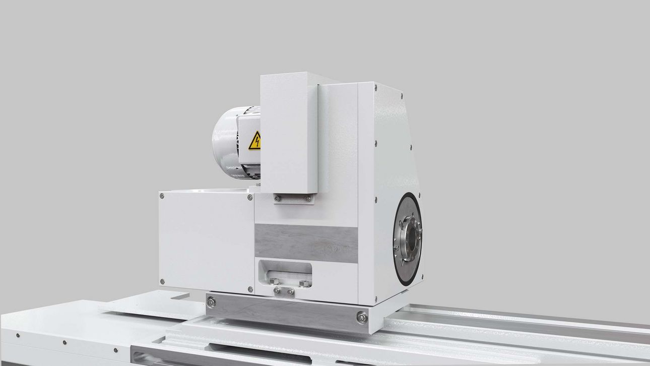

- Standard workhead with hydrodynamic bearing or workhead with roller bearing (option) allow grinding between fixed centers as well as with live spindle grinding

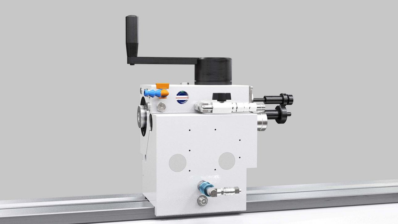

- Tailstock with adjustable centre pressure and fine adjustment for quick and easy cylindricity correction

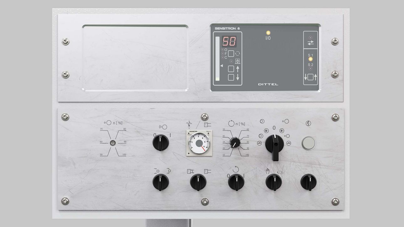

- Electrical enclosure permanently connected to the machine. Can be expanded for measuring systems and Sensitron
