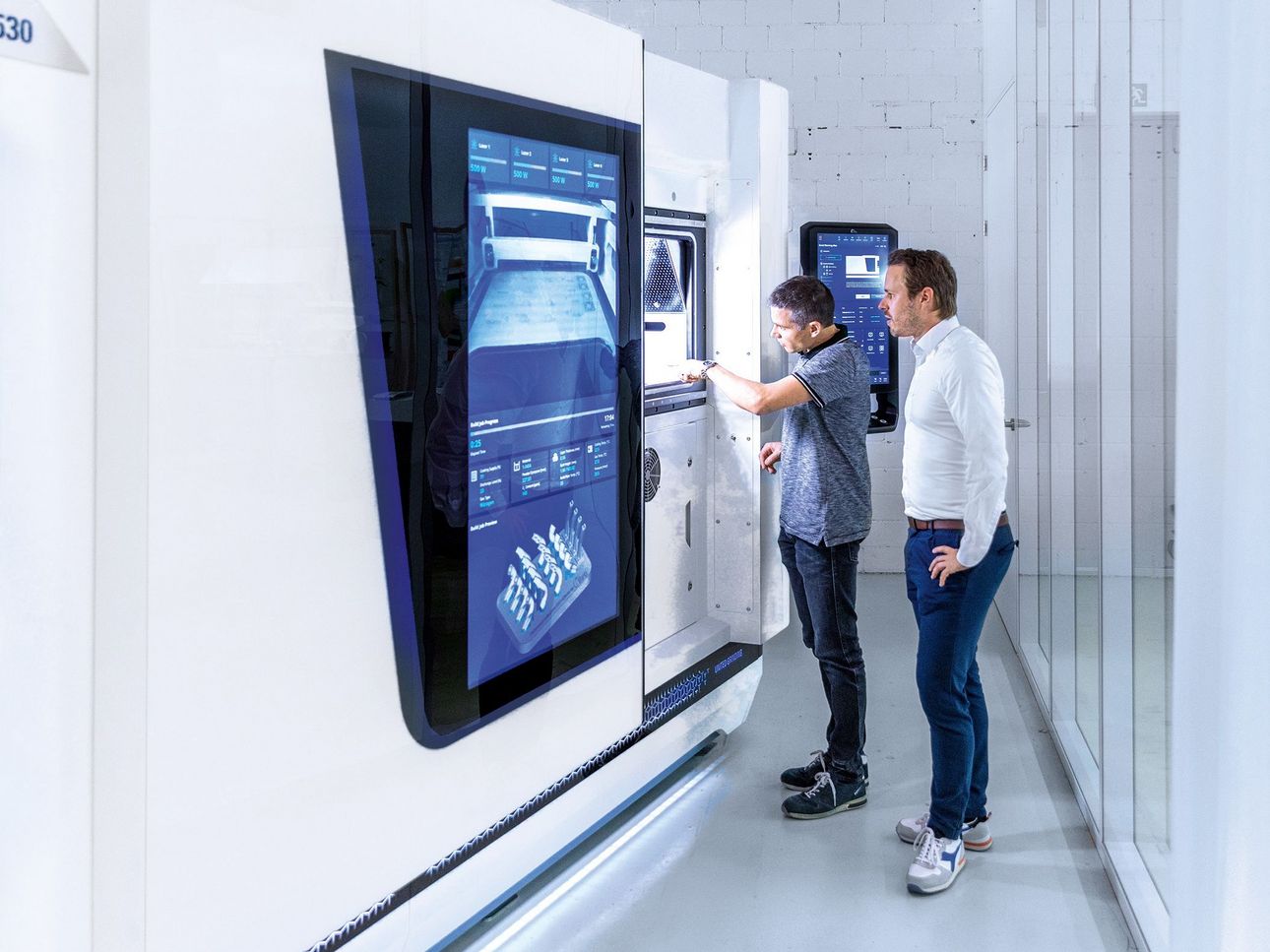

THE CLEAN NEW TURNKEY IMPACT 4530 stands in a room at the St. Gallen IRPD R&D center that was built especially for it. Its reputation already far proceeds it: the world's first industry-ready machine for additive manufacturing. There's no grinding of workpieces in this case; “manufacturing” in this case is actually precisely the opposite process. “Unlike classical production technology, where material is removed from a solid block by machining,” explains Paul Kössl, Head of Business Development and Marketing of UNITED GRINDING Group, “metal powder is used to build up a component additively, bit by bit as a layer beam melts it layer by layer (LPBF process).” The “face” of the IMPACT 4530 is an almost human-sized 54-inch touchscreen display in a friendly and intuitive design. This human-machine interface transmits the live images of the micro-welding process from a camera installed in the installation space and combines them with control elements and information on the process sequence. UNITED GRINDING Digital Solutions™ transfers data to the C.O.R.E. operating system. “It was a priority for us to integrate the IMPACT 4530 into the highly automated system network in a user-friendly way, enabling efficient networking with other machine tools,” says Köss

The IMPACT 4530 consists of two separate decoupled machine units. The thermostabilized, vacuum-capable machine core built on a cast-iron machine stand, the construction space, and the supply unit designed as a welding construction are successfully implemented as a separate operating and loading area. Together with the integrated automatic changeover system for the gas-tight metal powder containers and the components, this ensures the machine operable never comes into contact with the metal powder. While the IMPACT 4530 goes about its work, the screen shows the lasers dancing like four yellow flames, building circles, lines, corners, and edges atop a layer of the metal powder. This process is called selective laser melting of metal powders in the LPBF process (Laser Power Bed Fusion), which it handles with two or four 1000-watt industrial fiber lasers.

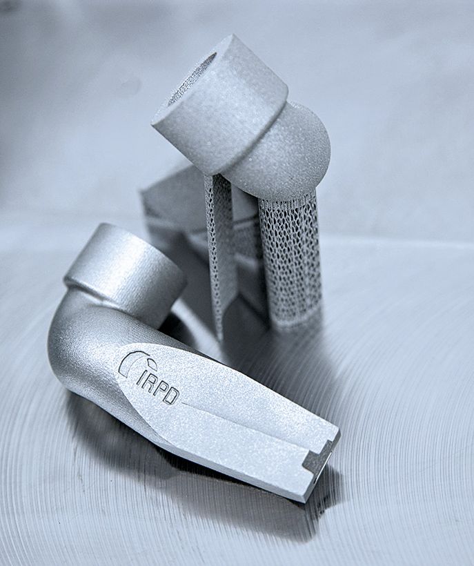

The metal components are ultimately welded together layer by layer on the plate. The metal powders are offered in different grades and in steel, aluminum, titanium and nickel-based alloys as well as special metals — the right selection and mixing is crucial for the quality of the products. One of the greatest advantages of 3D printing is that new, creative ideas can be implemented quickly and at low cost, says Michael Schneider, head of additive services & customer care at IRPD. “This inherently leads to better components and thus to better products.” Alongside Pascal Brunner, Kai Gutknecht, and Alex Frauchiger, Schneider is one of the experts who has been closely involved in the development of the IMPACT 4530 since 2016. Schneider explains creating workpieces seemingly out of nothing requires only the CAD 3D data of the desired component, which the printer uses to calculate the various layers. For example, the movement plan for the deflection of the laser is created by a mirror system, which melts the individual layers at specific points, thus fabricating the component. “The 3D printing process allows for components to be created that would not be possible at all using classic machining,” says Alex Frauchiger, who is responsible for process and material development. This is perhaps the most important principle in the use of additive manufacturing. It is not a question of replicating the classic process, but rather rethinking the components themselves and thus realizing the added value of additive manufacturing. “It always starts with the analysis of where additive manufacturing actually adds value,” he explains. This might involve faster production, new functions, or a combination of features.
