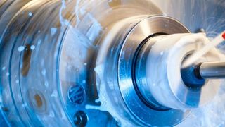

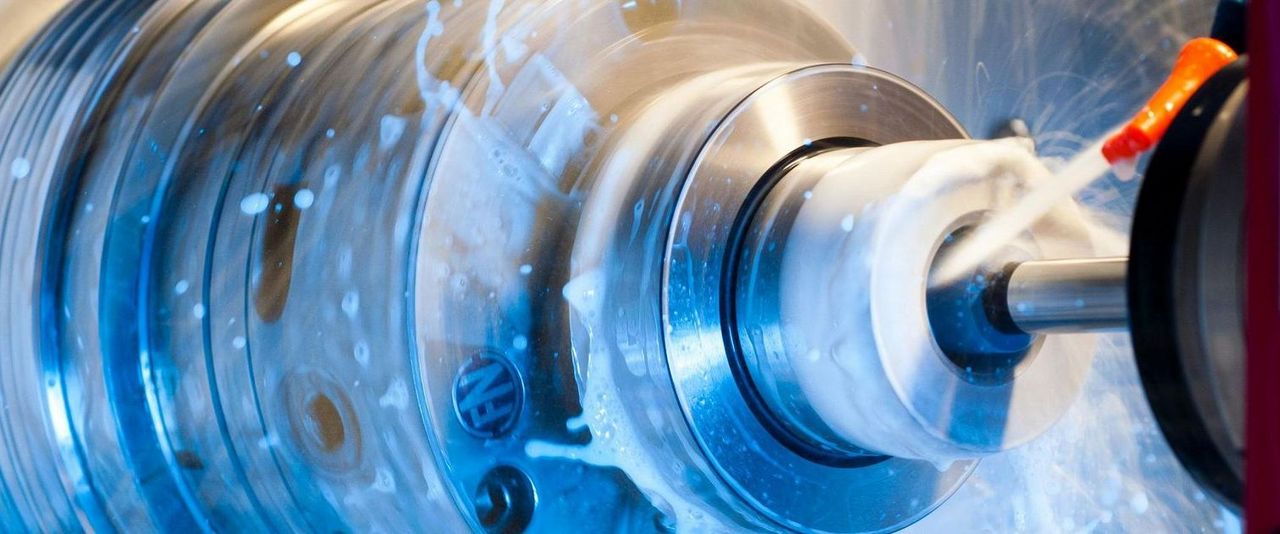

And most important of all: Identify your hot point and direct the right amount and pressure of fluid to it. The “hot point” is the precise point(s) where wheel and material meet, creating the highest temperatures. Regulating these temperatures is paramount, so precise nozzle aim is essential. If you’ve chosen one of the UNITED GRINDING brands, you have access to the Tool Studio software. The software shows the exact hot point, allowing you to aim your coolant nozzles with exceptional precision.
Following these best practices helps overcome the physical challenges of cooling a grinding machine moving at 2000 RPM. Turbulence on the periphery of a wheel moving at such high speeds naturally introduces air and creates misting. Compound this with improperly aimed nozzles, and the 10% coolant delivery is an at-best figure.
