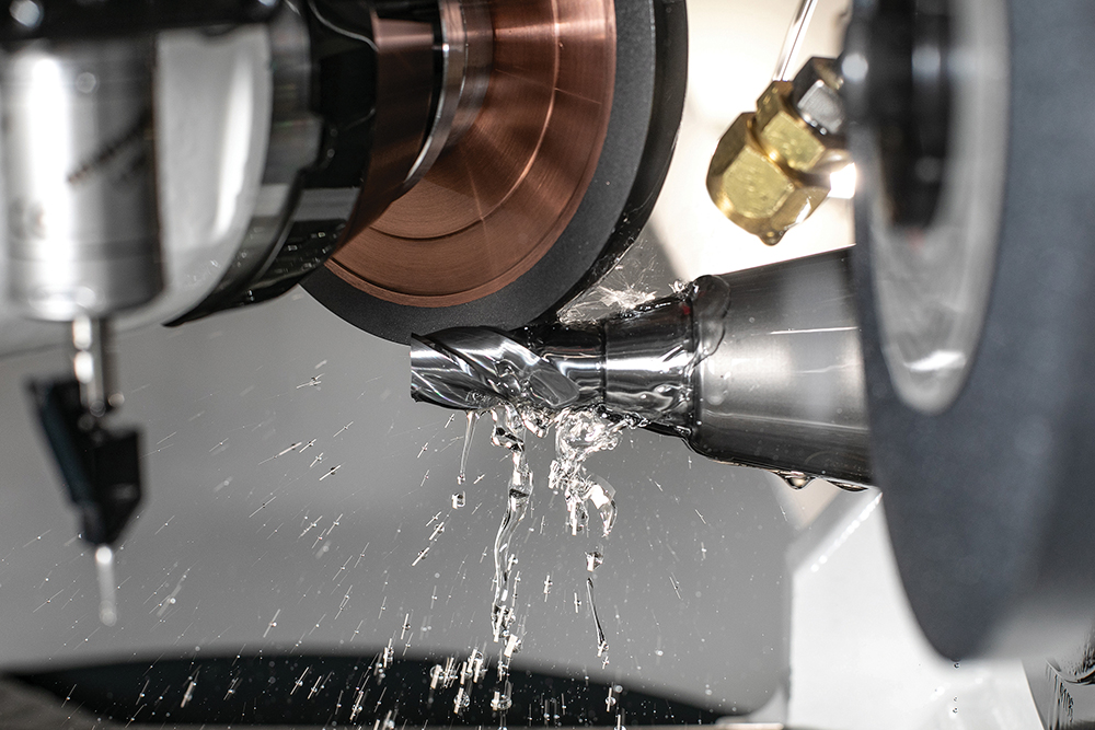

Close up of a CDT’s EVO Hybrid Bond grinding wheel as it performs a flute grind on a cutting tool and coolant hits the grind zone. Wheel specification, coolant delivery, and process parameters all must work together to achieve efficient, high-quality grinding performance.

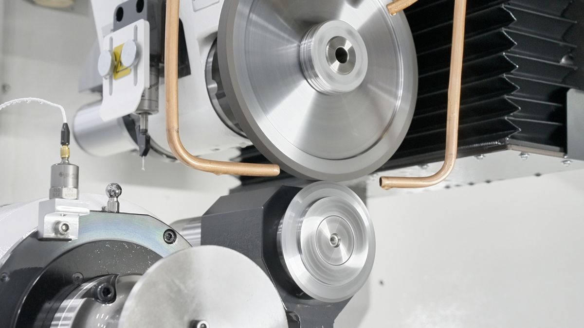

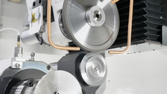

In this photo, a vitrified CBN wheel is traverse dressed with a CDT diamond rotary dresser. Dressing strategy is driven by wheel spec and process setup—critical factors in both performance and wheel life.
3. Truing and dressing.
All grinding wheels wear over time due to the forces involved in grinding a workpiece. The type of dresser you use will depend on the wheel spec, and how often you dress will be influenced by choices made in later stages of the setup. That said, excessive dressing can signal a mismatch in your setup—potentially pointing to issues with wheel selection, machine settings, or grinding conditions. For a practical example, check out Episode 5 of The Grinding Chronicles, where Continental Diamond Tool demonstrates how to dress a vitrified CBN wheel using a rotary diamond dresser.

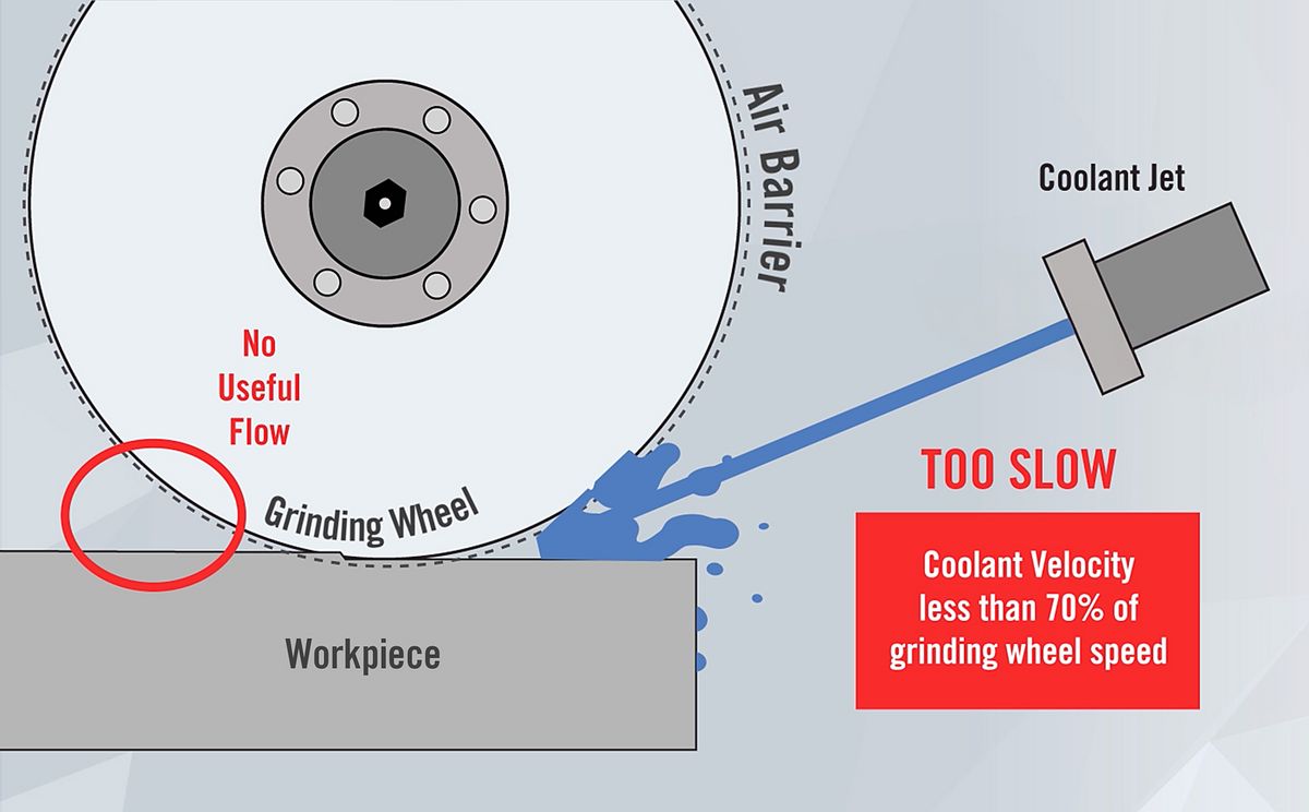

This diagram shows what happens when coolant jet speed is slower than the surface speed of the grinding wheel: blowback deflects fluid away from the grind zone instead of allowing proper penetration. Velocity alignment is critical for effective cooling and process stability.
5. Fluid dynamics.
Grinding generates significant heat, so setting up an effective coolant delivery system is essential. Damaged or misaligned lines can prevent fluid from reaching the grind zone, reducing wheel performance and part quality. Surprisingly, sometimes a small tweak to this system is enough to fix an issue—even when coolant isn’t the obvious culprit. Coolant delivery can be checked by comparing nozzle pressure and machine flow rate against expected values. While excess flow mainly affects efficiency, excessive velocity can disrupt coolant penetration and raise temperatures—especially if jet speed exceeds wheel speed. For more on coolant velocity, see The Grinding Chronicles, Episode 3.

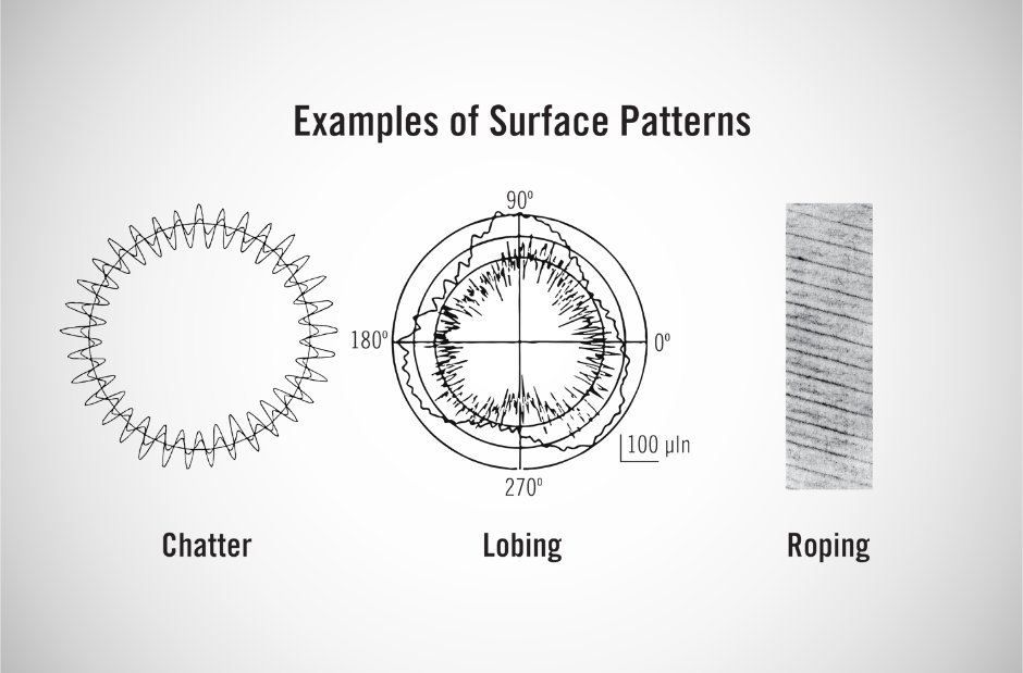

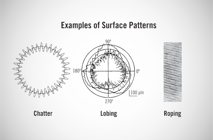

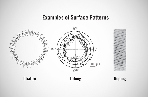

High cycle times are only beneficial if they don’t come at the cost of scrap parts. While we've discussed the risk of thermal damage, most applications also require strict standards for profile and surface finish. Profile refers to the macro geometry of the part and is driven by wheel spec and wear. As the wheel degrades, the profile may drift—requiring dressing to restore accuracy. With superabrasive wheels, the goal is to maximize durability and minimize the number of parts per dress. Finish, on the other hand, refers to the microtexture or surface quality and is affected by abrasive concentration, grit size, material removal rate (MRR), and wheel speed. A video featuring practical, science-based advice for addressing profile and surface finish is scheduled for release this summer on Continental Diamond Tool’s YouTube channel.
If you're seeing surface patterns like chatter, lobing, or roping, machine dynamics could be the root cause. Identifying whether vibration is forced or self-excited is the first step in diagnosing and correcting these issues.
8. Machine dynamics: chatter and vibrations.
If vibration is present—often seen as chatter marks on the workpiece—first determine whether it’s forced or self-excited. Forced vibration comes from external sources and can often be resolved by finding and fixing the disturbance. Self-excited vibration may require a modal analysis to understand and address the system’s dynamic response. Speeds and feeds can influence vibration, and iterative adjustments may help. That said, if chatter continues, it may point to issues in your system—requiring a closer look at the wheel, spindle, machine, and workpiece setup. For more on chatter, watch The Grinding Chronicles, Episode 7.
