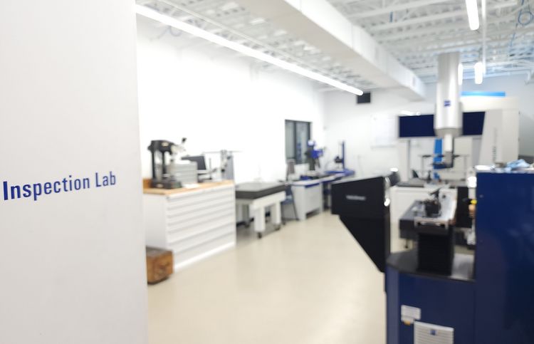

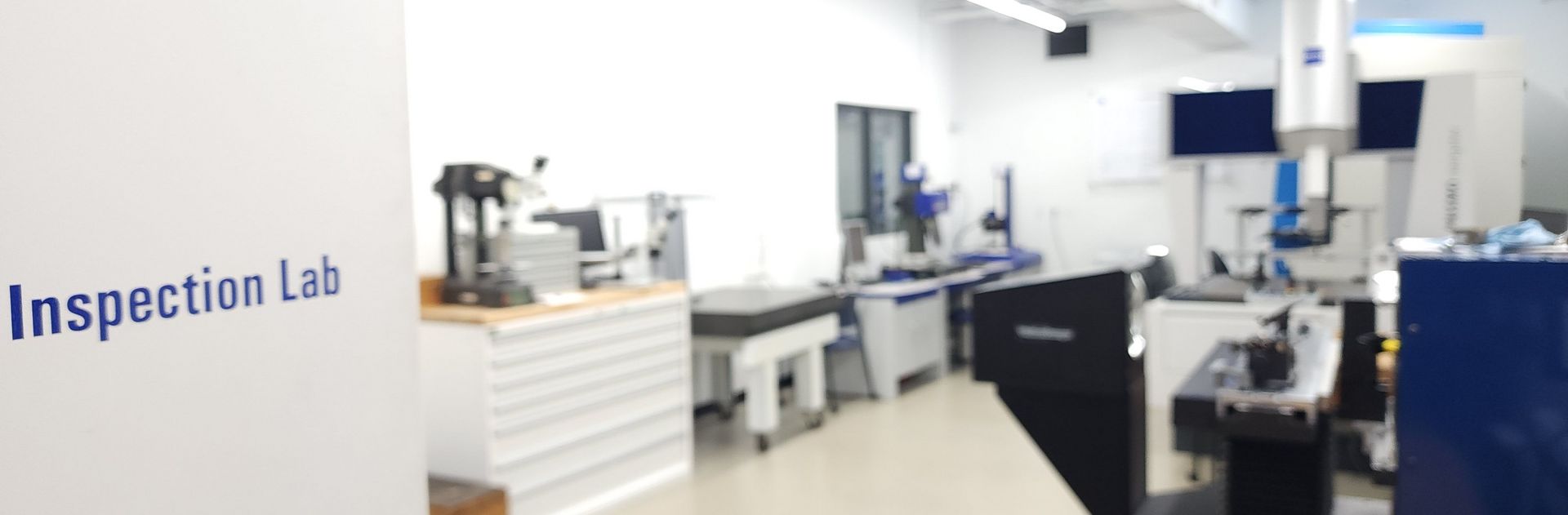

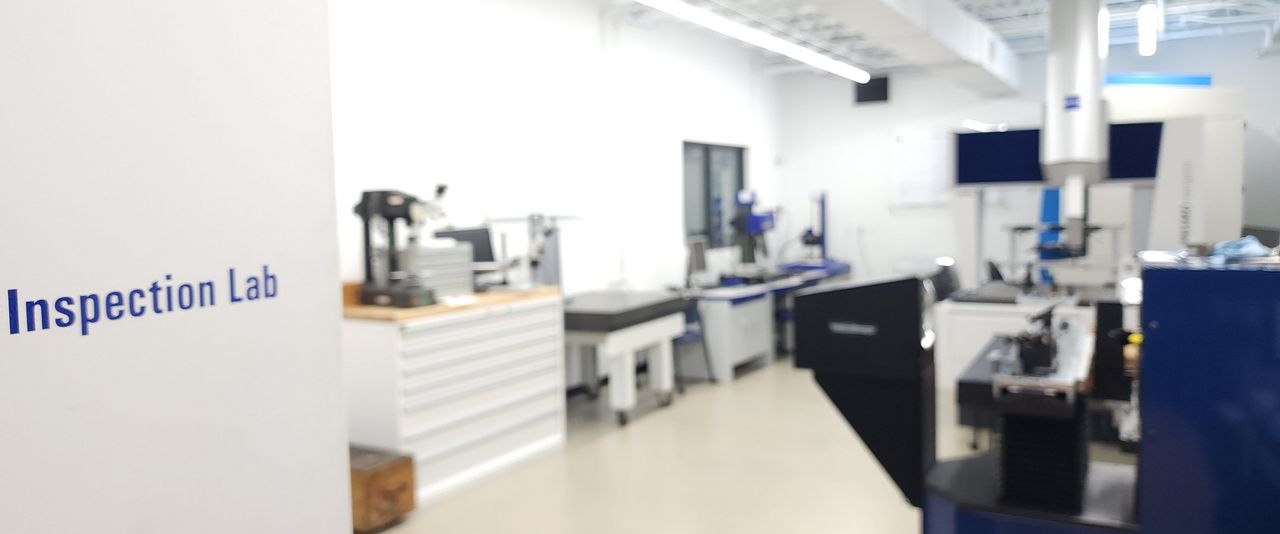

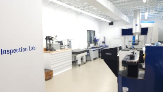

Our Application Engineers gather all the info that they can during the test grind, with a crucial factor being the accurate measurement of the parts. At UNITED GRINDING North America, we have an inspection lab with millions of dollars worth of measuring equipment in a room that’s specifically climate controlled for gathering precise measurements. In the off-circumstance where we don’t have the right piece of equipment to gather the required measurements, we’ll ship the part to a specialist who is able to gather these measurements for final confirmation.
