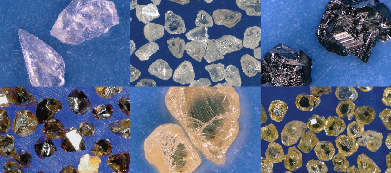

The material to be ground — whether metal, ceramic, composite, or other substance — is the first thing to consider when selecting the abrasive for a grinding wheel. Conventional abrasives like aluminum oxide and silicon carbide have been used in commercial grinding since the 1800s. Superabrasives are a newer technology, composed of diamond or cBN. Superabrasives excel at grinding hard materials with precision and offer the longest wheel life and high removal rates for the most demanding grinding applications. It’s important to evaluate how a material’s chemical and physical properties—such as hardness and reactivity—interact with an abrasive’s attributes to identify the most effective solution.
In general, conventional abrasives such as aluminum oxide or zirconia alumina should be selected for applications that involve grinding steels and steel alloys where carbon reactivity can be a concern. When it comes to superabrasives, experts would recommend cBN for grinding steel for this same reason. For cast iron, nonferrous metals, and non-metallic materials where reactivity is not an issue, diamond or silicon carbide abrasives will usually be more effective, especially with hard materials.

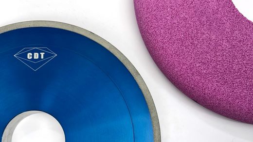

Machinists rely on grinding wheels to achieve the desired surface finish as well as repeatability and accuracy of part geometries. Two critical factors in this process are the grit size of the abrasive grains and the bond system, which holds these grains together. Together, they determine the grinding wheel's ability to meet finish and form tolerance requirements. Selecting the proper grit size and bond system is essential for achieving the best results.
Grit size refers to the size of the abrasive particles in a grinding wheel, and it directly affects the surface finish of the workpiece. Larger abrasive particles (a smaller mesh number) generally remove material faster but leave a coarser texture. Conversely, finer grits (a larger mesh number) remove less material per particle but produce a smoother surface finish. Grit size also impacts form tolerance, as fine-grit wheels are especially useful for grinding intricate details on parts. Their ability to remove less material per pass allows for greater precision in shaping.
When it comes to form tolerance, the bond system of a grinding wheel plays a critical role in influencing its precision. The bond system, which adheres the abrasive grains together, provides the structural integrity needed to perform grinding operations effectively. Different bond systems can be tailored to achieve specific results. For instance, changing the porosity of the vitrified bond system of conventional abrasive wheels can improve shape retention during grinding, which enables tighter form tolerances.
Superabrasive grinding wheels come in several different bond types that can be customized for better performance and precision. Their hardness, wear resistance, cutting efficiency, and shape retention help deliver consistent results in demanding applications. Changes to the bond system can enhance these properties, further improving the wheel's performance for specific needs. When precise shapes are needed, selecting the right abrasive size and bond type is essential for maintaining tight geometric tolerances, ensuring accuracy, and meeting part specifications.

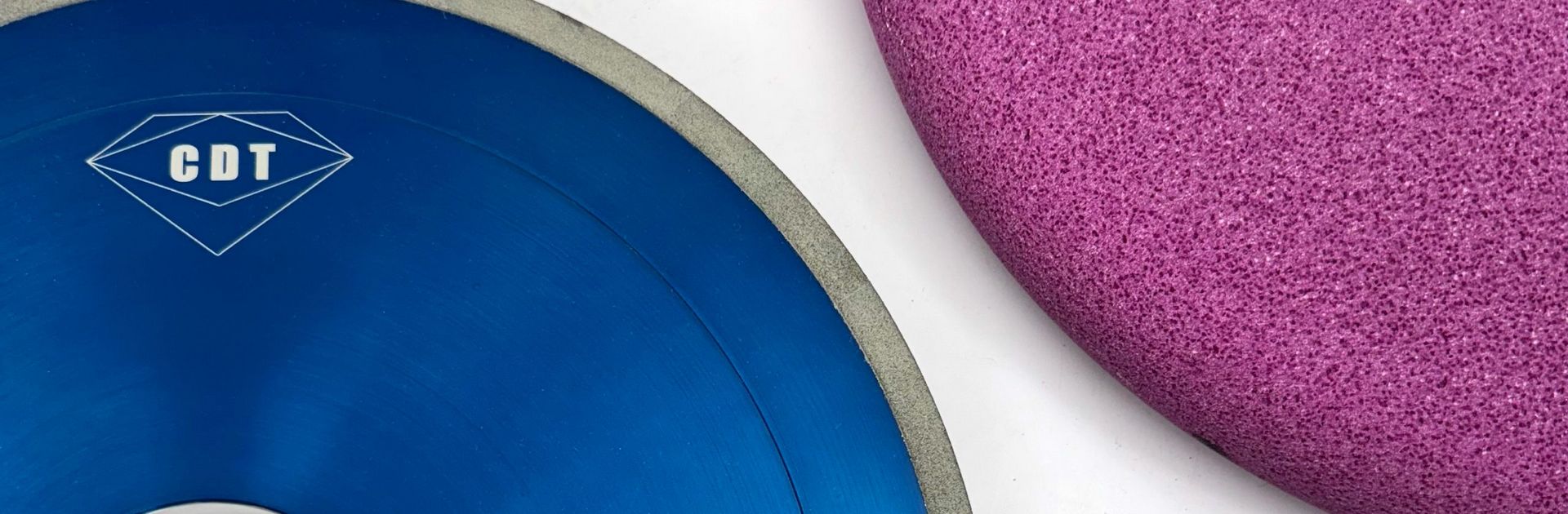

As grinding wheels get larger in size, their weight can pose a concern for employee safety and machine integrity. Conventional abrasive grinding wheels are a solid form of abrasive material, whereas superabrasive grinding wheels bond their abrasive to an inner core. Core material selection impacts the weight. For example,a steel core used on a large diameter OD or creep feed wheel might make it too heavy to reasonably maneuver and cause excessive stress on the machine. Instead, a carbon fiber or aluminum-core wheel is a more practical choice because of their lower weight. For an in-depth look at the science behind wheel body selection, watch CDT Engineering Manager Jeff Wirth in Episode 10 of The Grinding Chronicles.

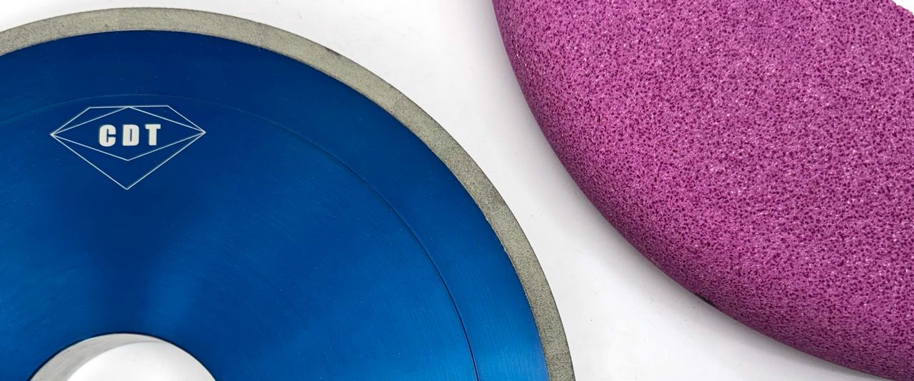

The cost of a grinding wheel often comes into play during the selection process, and rightfully so. A conventional aluminum oxide wheel can cost around $300 to $500, while that same wheel made of superabrasives might cost $5,000. When evaluating cost per part, however, that can change the perspective entirely. By running a cost analysis, it is likely that the part is significantly less expensive to produce with the superabrasive wheel, assuming the operator is running the technology to its full advantage. If a less skilled operator is likely to crash a machine, it is less expensive to lose a $500 wheel than a $5,000 wheel. As with anything, it’s important to consider all factors.
