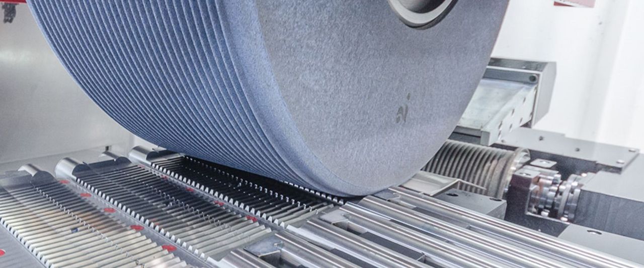

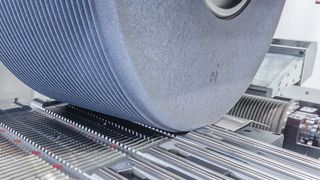

Creep feed grinding also is a space-efficient alternative to broaching. Fir-tree forms common in aerospace often require a broaching setup that could be 30 to 40 feet in length. Creep feed grinding allows the same machining to be performed within a typical-size machine tool.
Why Continuous Dressing Creep Feed Works So Well for Hard Materials
The continuous dressing of grinding wheels keeps temperatures in check and the wheel sharp. Because the wheel is always sharp, lengthy cuts are possible, which drives efficiency. Plus, this consistent wheel performance results in lower average grinding forces and leads to even more efficient abrasive use, shorter cycle times and increased production rates.
CDCF oftens allows the reordering or combining of processes. What previously was done by milling, outsourcing for heat treatment, and finishing often can now be done with CDCF in one clamping or setup. The savings are significant.
One UNITED GRINDING customer made a medical device implant that took about an hour per part with 20 percent of material being scrapped. The manufacturer introduced CDCF to their shop and no longer had to stop production for dressing, instead dressing and grinding simultaneously while being more aggressive with cuts. They were able to maintain the profile shape and the size of the part and reduce the cycle time to about 10 minutes. They have significantly also reduced downtime and scrap while producing a higher-quality part.
