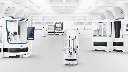

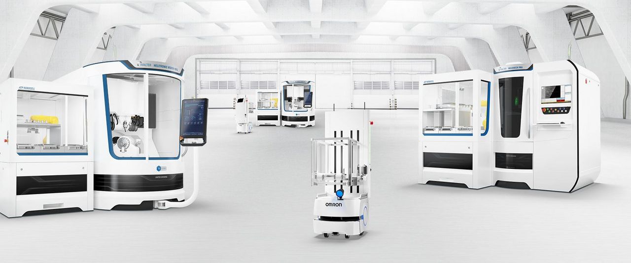

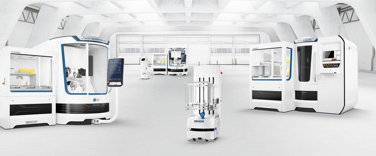

With the new „Automated Tool Production (ATP)“ system, WALTER now offers an automation solution for cylindrical precision tools. ATP is the innovative solution for connecting grinding, eroding and measuring machines from WALTER, as well as upstream and downstream machines from other system partners in the production process.
The ATP system requires no additional floor space, can be integrated into existing system layouts and is also suitable as an interface for machines from other manufacturers. It consists of at least one robot cell (ATP ROBOCELL) accessible from the front for automatic loading and unloading of the machines and at least one autonomous, mobile transport robot (ATP Mobile Robot) for transporting the tool pallets and individual parts between the storage and processing stations. This also includes a standardised communication model between the machines and the ATP AMR transport robot as well as a control system for higher-level data and process control.
