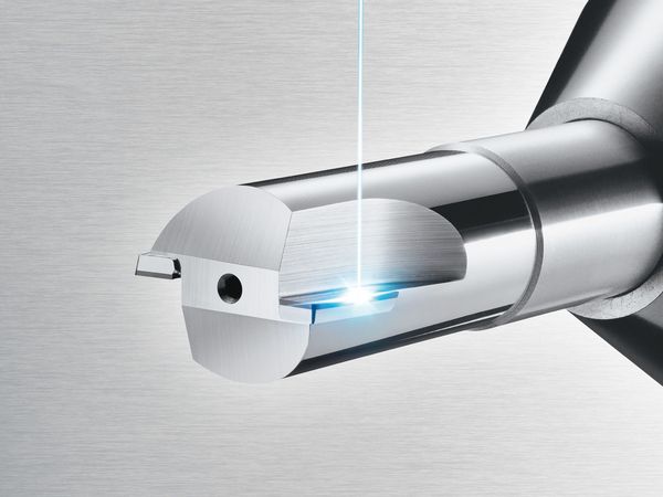

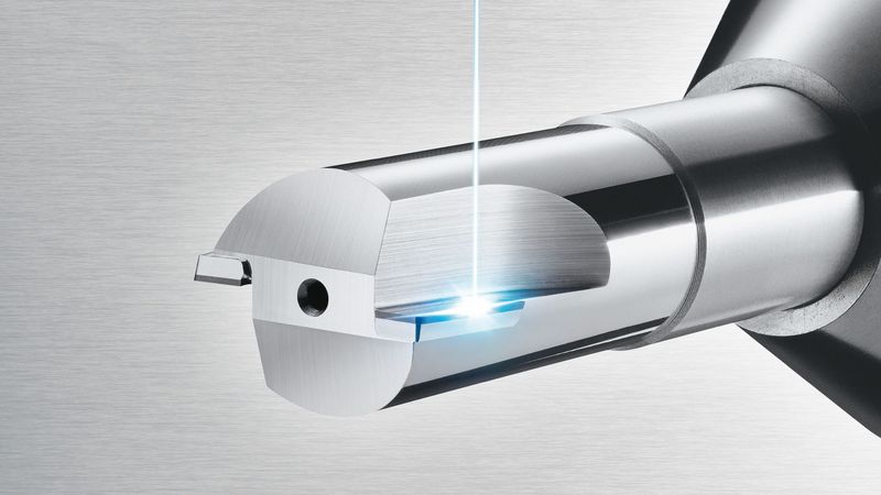

Laser ablation (sometimes referred to as laser blasting) removes material from a solid surface by irradiating it with a laser beam in a highly controlled manner. This technology can be applied to manufacturing cutting tools in a variety of substrates, including more challenging materials such as CBN, PCD and CVD-D.
Unlike conventional cutting tool grinding processes, laser ablation prevents cracks on the cutting tool surface, which in turn produces extremely sharp cutting edges. It also enables a higher level of flexibility in the production of complex geometries, such as concave blade surfaces.

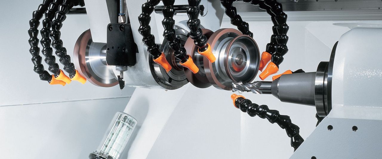

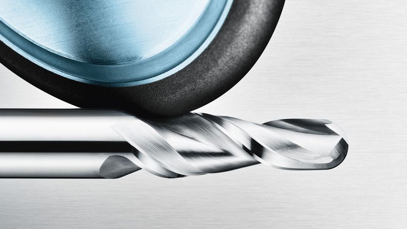

It’s possible to grind micro drills, micro end mills and other micro tools as small as 0.1 mm (0.004”) in diameter. But as tool diameters get smaller, a wide range of factors become increasingly critical to maintaining the precise and complex forms that these micro tools demand.
A vibration-free, rigid machine base is the foundation for all tight-tolerance and small diameter cutting tool grinding. Linear drives controlled via an integrated high resolution measurement system are needed to produce exact movements in all axes, and direct-drive spindles eliminate the vibrations associated with belt-driven spindles.
Also key to producing complex geometries on micro tools: machine kinematics, coupled with flexible software.
In addition to machine design, grinding wheel composition and characteristics as well grinding wheel dressing methods and frequency are even more critical in micro tool grinding operations. Precise and rigid workholding is also a key consideration, as repeatably gripping the cutting tool shank throughout the micro tool grinding process is essential for a precision product.
