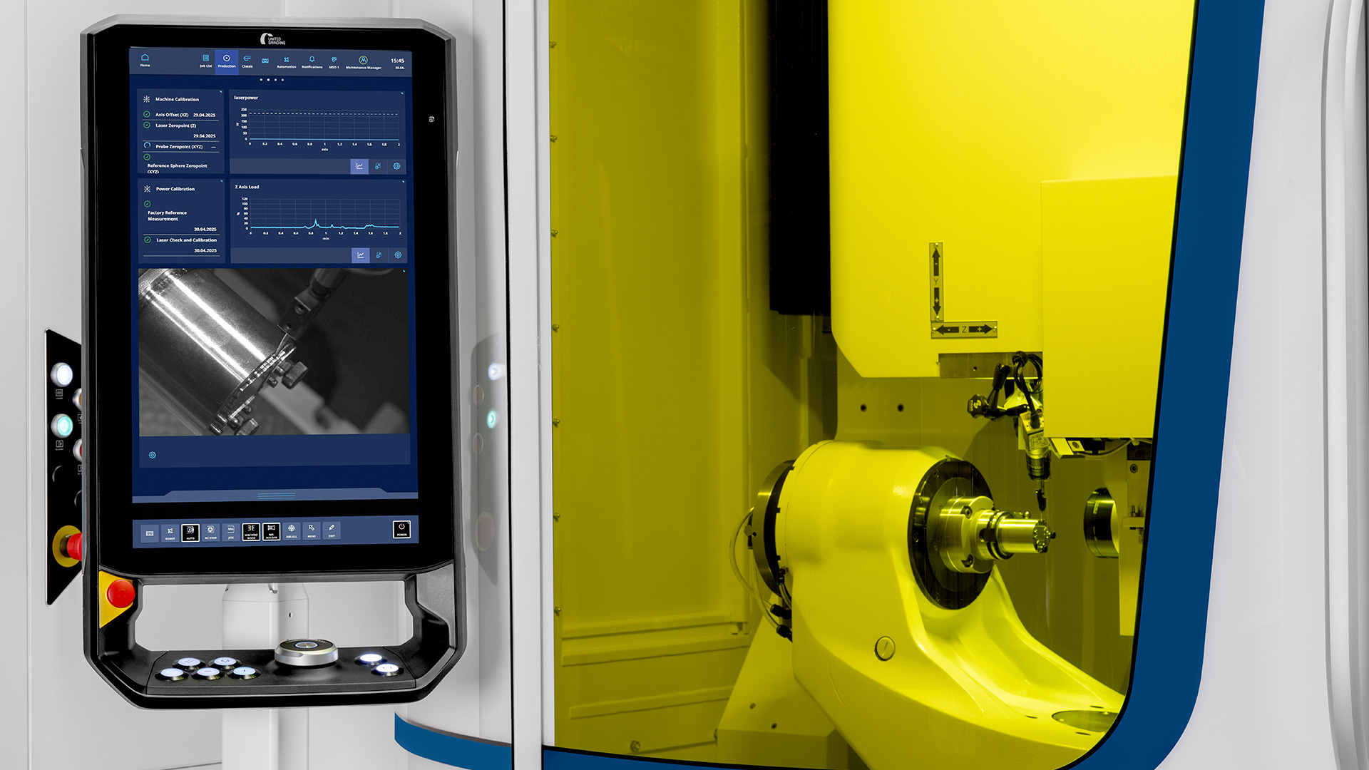

Automatic calibration
Precision made easy. Automatic calibration of the axes, the laser focus position, and the center of rotation minimizes operator effort and enables highly precise and efficient manufacturing processes.

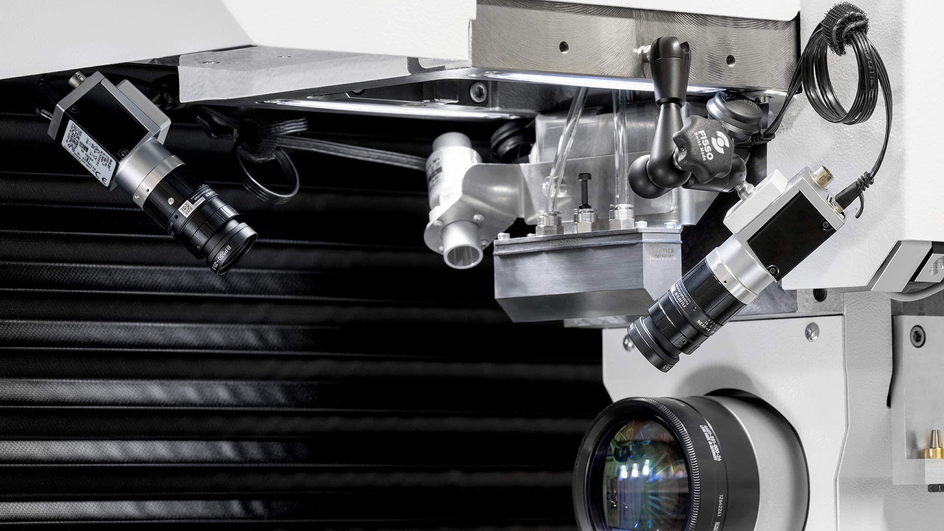

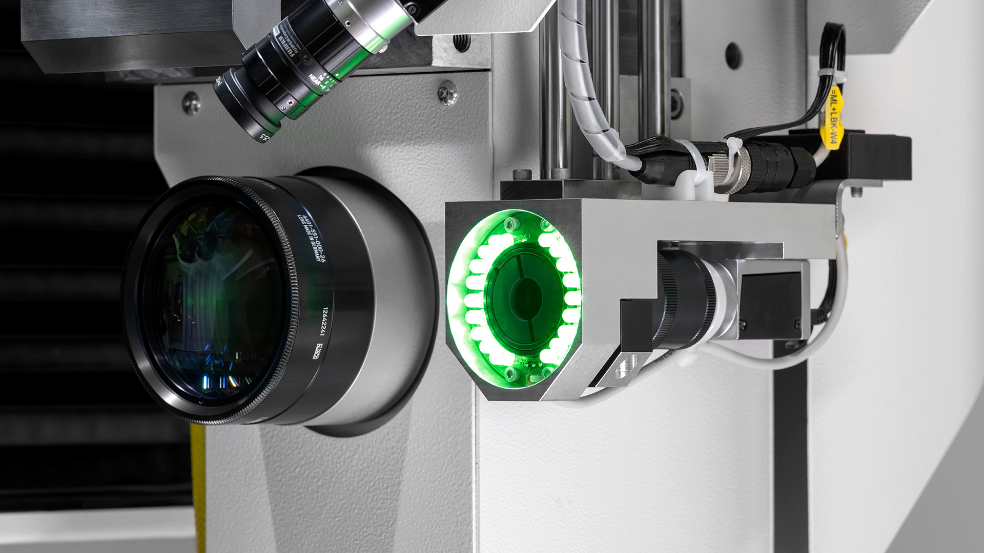

Live process cameras (optional)
Für das Einmessen der Rohlinge und für die Überwachung der Bearbeitung sind optional drei Kameras verfügbar, die den Bearbeitungsprozess in einer Übersicht oder einzeln im Vollbildmodus anzeigen können.

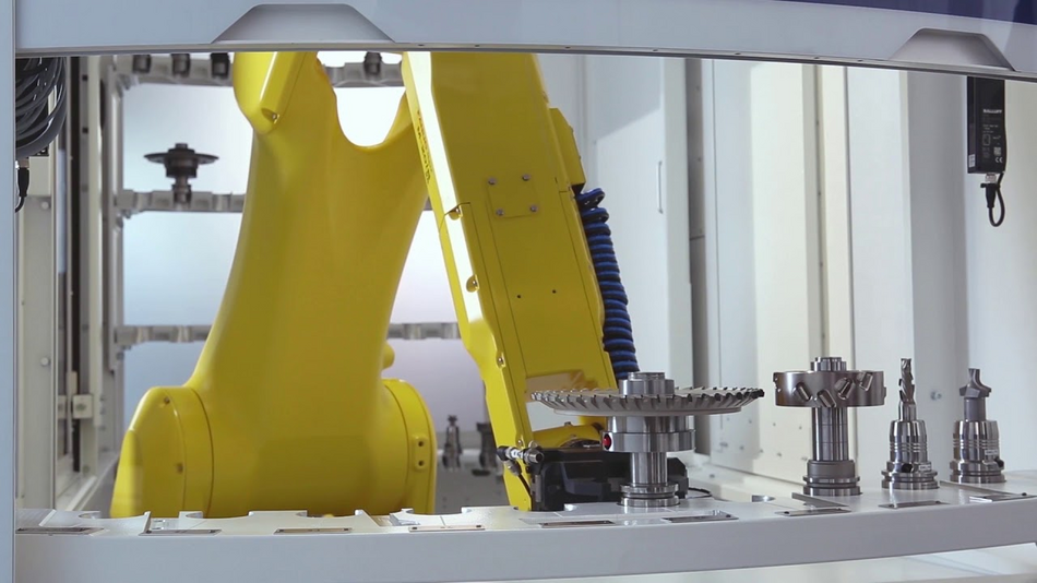

Automation with Robot Loader 25 (optional)
Folded-arm robot with 6 controlled axes for automatic loading of tools. User-friendly “Process Manager” software for convenient programming of loading operations and intelligent management of tool magazines. Automatic teaching enables short setup times. Depending on the type of workpiece or workpiece diameter, up to 70 workpieces can be loaded via the robot loader. Maximum workpiece weight: 20 kg; maximum workpiece diameter: 250 mm
