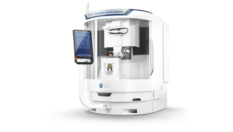

The tool eroding machine HELITRONIC POWER DIAMOND 400 with C.O.R.E.-Technology can erode tools made of PCD/CBN material and grind tools made of high-speed steel/carbide.
It can produce tools with a diameter of 3 to 380 mm, a machining length of up to 520 mm and a piece weight of up to 50 kg.
New with Laser Contour Check option!
Features
Gantry design
The WALTER gantry design in cast iron with its good damping properties ensures excellent tool surfaces.
Belt-driven spindle with two spindle ends
The powerful belt-driven spindle with two spindle ends can accommodate up to 3 electrodes resp. 6 grinding wheels with a maximum diameter of 254 mm and has a maximum peak power of 24 kW.
Linear axes
The machine has three linear axes X, Y, Z with ball screws and a maximum traverse speed of 15 m/min.
Option Grinding wheel changer 4/8
With a capacity of 4 to 8 grinding wheel adapters, the grinding wheel changer multiplies the grinding wheel capacity of the HELITRONIC POWER DIAMOND 400.
Fine Pulse Technology
The latest eroding technology for a great eroding process. Excellent surface finish and minimal chipping
Laser Contur Check
The new, innovative Laser Contour Check option offers an intelligent measuring system integrated directly in the tool grinding and eroding machine for the highly accurate, non-contact measurement of various tool parameters on cylindrical tools.
