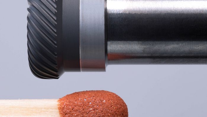

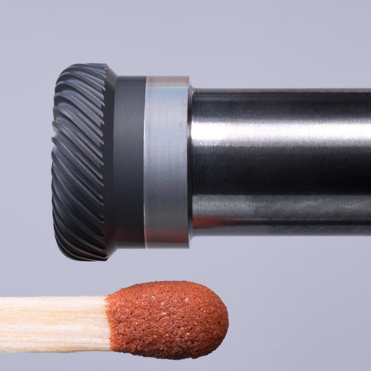

PCD PROFILE CUTTERS
Since the iPhone 6 and Samsung Galaxy S5 smartphone generations, increasing emphasis has been placed on machining with tools produced by laser technology. On the Apple iPhone 6 for instance, the bevel on the aluminium housing is machined with PCD profile cutters. On the iPhone X however, stainless steel is integrated into the housing frame. These cannot be machined with diamond- coated tools such as PCD due to the chemical affinity with ferrous materials, and Tailor-made tools to meet customer requirements: Dr. Claus Dold, Head of Process Innovation at EWAG CBN cutters are used instead. These tools can also be manufactured with machines such as the EWAG LASER LINE ULTRA or the LASER LINE PRECISION. With new demands on design and technology, materials such as glass and ceramic are being used increasingly, not least due to the arrival of 5G smartphones. These materials offer a number of advantages. One relates to the reception quality of smartphones: “In principle, metal housings shield wave transmission in wireless communications”, explains Andreas Bußmann, expert in terminal devices at Deutsche Telekom. Therefore, on devices with a metal housing, this is used for the antenna. “For this purpose however, it must be shielded from other integrated metal parts. This is done with plastic strips.”

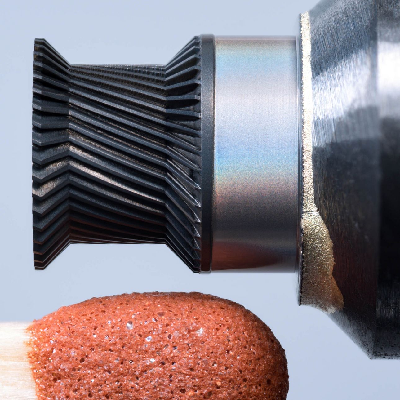

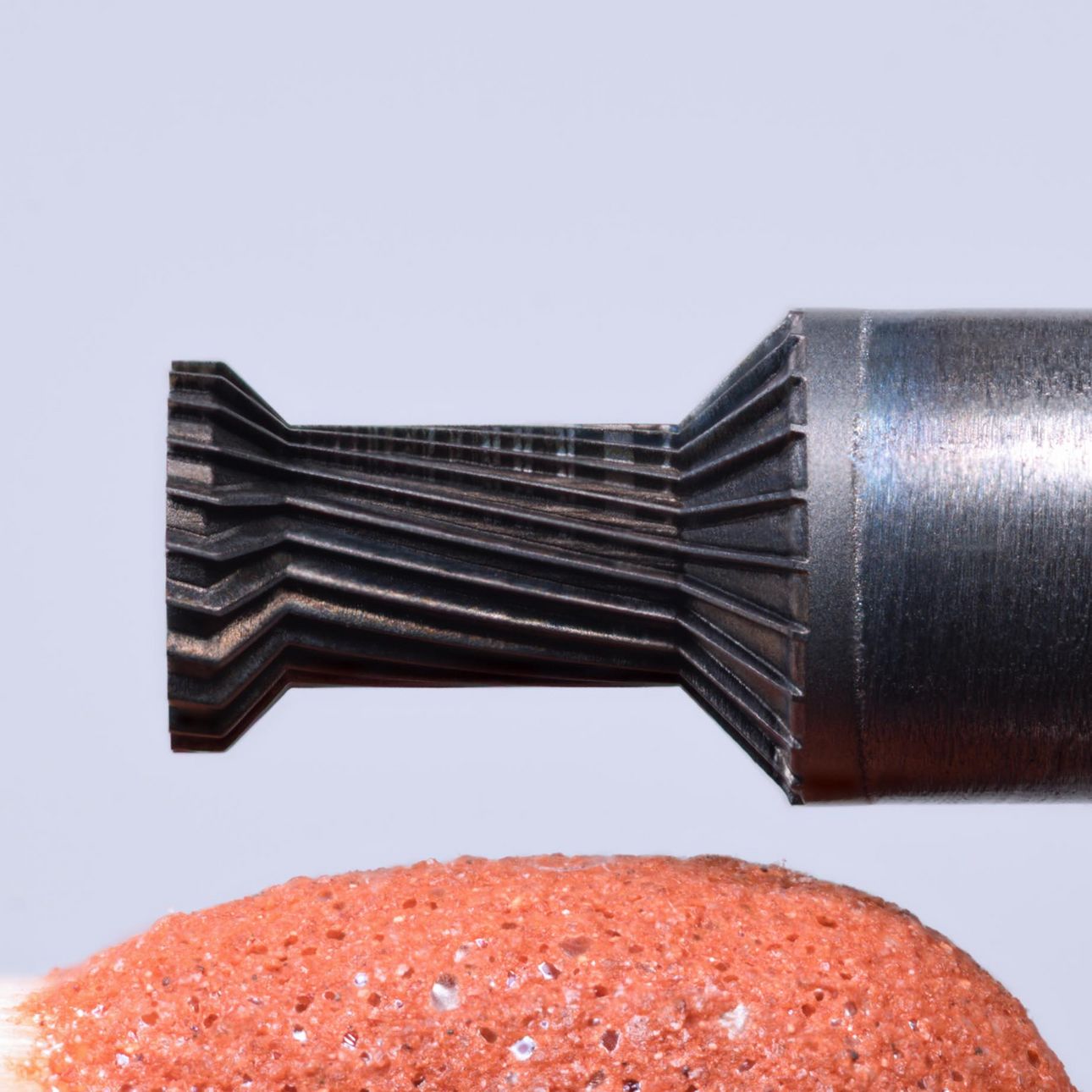

HIGHLY SPECIFIC GEOMETRIES
“We increasingly receive customer requests for 3C tools with highly specific geometries, for use in machining glass housings for instance”, explains Dold. “To fulfill the particular requirements on customers’ individual tools we then develop the machining and programming steps for our laser machines, to enable us to manufacture these tools.” ”The smallest internal radii, turned parts, shoulders and other geometries can be produced with these tools”, says Dr. Gregory Eberle, Laser Technology Process Specialist at EWAG. In conventional machining, tools with these geometries would have to be assembled from several parts. With an EWAG LASER LINE ULTRA for instance, they can be produced fully automatically and in one work step.
