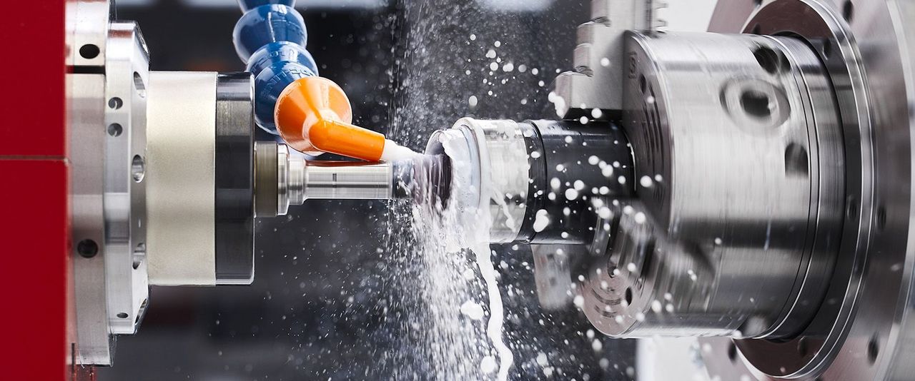

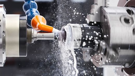

The rundown on water-miscible coolants
If you need your coolant to be streamlined and less expensive, water-miscible options are the play. “It does a great job taking heat away from the part,” said Cappadona. “You don’t need any extra equipment or peripherals like you do with oil-based.”
“That said, water-miscible coolants have higher maintenance required because they can foul due to bacterial growth, and systems can be infected with fungus if not managed properly. It requires more monitoring and control. And for materials like HSS or carbide, you’re probably better off using an oil-based coolant if you’re able.”

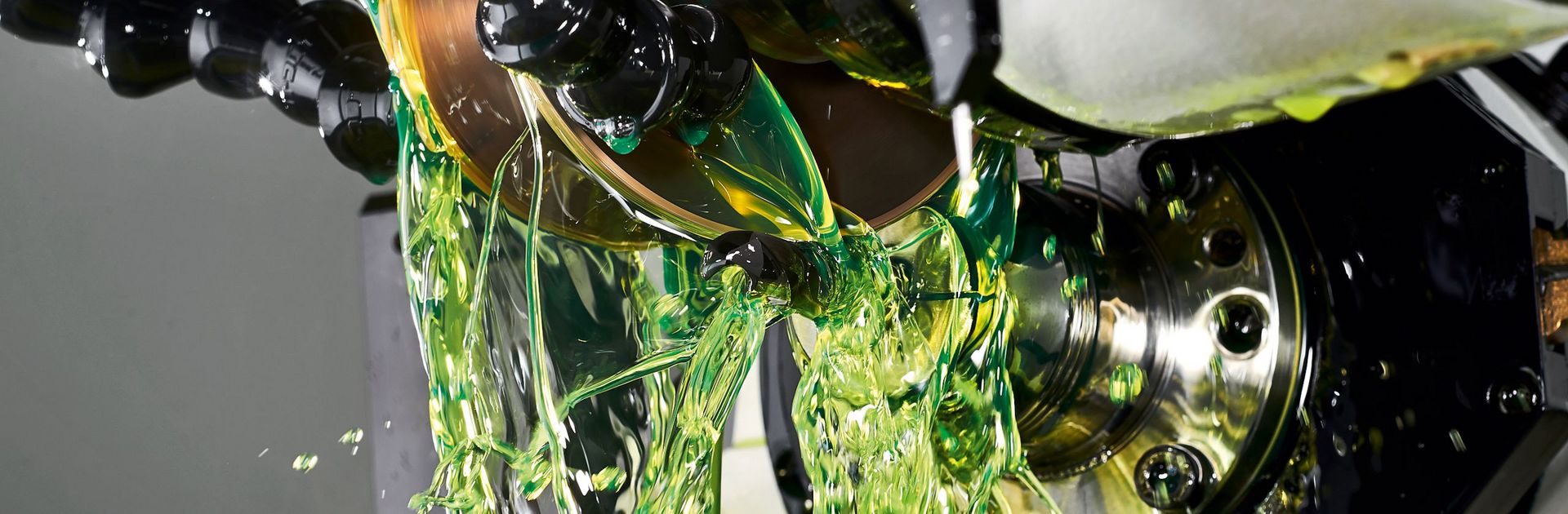

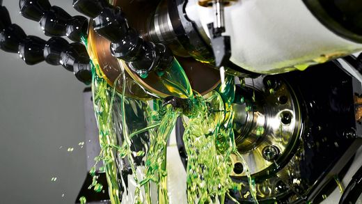

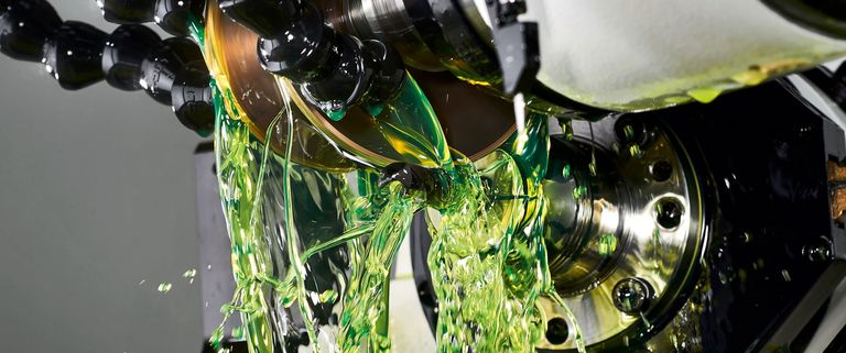

The rundown on neat oil-based coolants
It may cost a bit more in equipment and peripherals, but oil-based coolants are trusted for their ability to bring high MRR as well as peace of mind. “Oil does a better job than water, thanks to its lubricity and additives package, at not generating heat,” Cappadona said. “With materials like carbide or HSS, oil-based reduces friction/heat to achieve higher MRR.”
It’s important to have a high quality base oil: either hydrocracked, gas-to-liquid or polyalphaolefin (PAO). The flashpoint is very important too. Flashpoint is the temperature at which vapors become flames. For reference, the Blasogrind GTM 10 (near oil for HSS and carbide) has a flashpoint of 374 degrees Fahrenheit. Comparable coolants have flashpoints between 275 and 320 degrees.
On the downside, using oil-based coolant will require fire suppression and a chiller to keep the temperature down. This is a vital point about neat oil coolants that is worth repeating: fire suppression is an absolute must.
